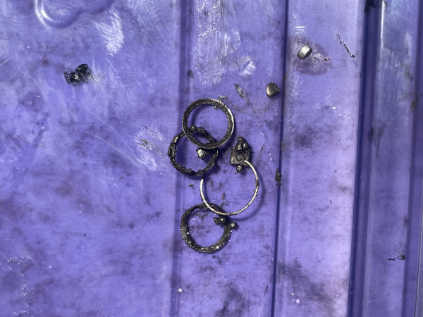

I'm stuck again, and I need your help.
After landing two fish of a lifetime at Cedros Island last August My Tranx 400 took a dump.
When I got back home and pulled it apart the bering under the drive shaft had been completely destroyed.

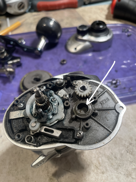

I bought a replacement and realized the outer race of the destroyed bearing is stuck in the frame, I can't get it to budge.
Have any of you ever experienced this? I'm afraid to go digging to aggressively to get it out, I don't want to damage a very expensive reel.
Please see pictures and thank you for always helping with your wisdom and advise.

The last resort after everything else fails is to use a Dremel or Foredom with 3/32 inch carbide bur to cut a slot in the race.

Try hitting it with penetrating oil and sticking it in the deep freeze for a day or two, might shrink enough to move?  I suspect it will come eventually, I find my patience is usually rewarded.

  I would try two common head  nails or paint can openers and use them like a lady slipper pry bar .
for that last resort, you can also use a diamond-dust bit,
but don't cut all the way through the steel, or you'll likely damage the alloy frame
better off cutting several slots, part of the way & the race should "release" or break apart

I use a box nail and cut part of the head away and hold it with some visegrips.
Phishface
Thank you all for your suggestions, thought I'd post the result. I used oil to loosen the race and used MarkT's suggestion. I ground two nails and put them in vice grip to pull the busted outer race out of the frame. Thank you MarkT, Man did I fret about how to get that thing out and tried prying it out so many different ways.
