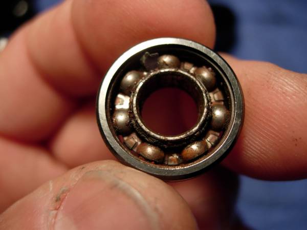

these bearing are gummed up, but not rusted.  with a small pen knife, pry out the shields and let's clean them out with carb cleaner and compressed air, then lube them with corrosion x.  by cleaning the bearings rather than replacing them, we'll save someone $40-50!

the original bearing was totally rusted, so the shields were removed from a new bearing, and the bearing was packed with grease.

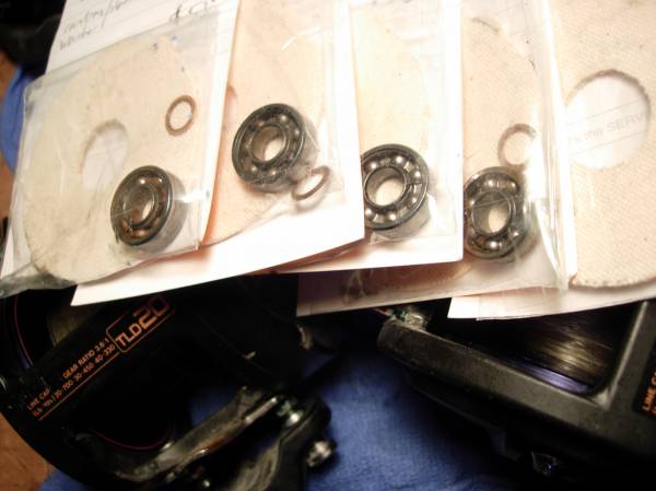

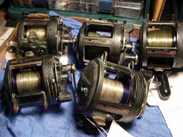

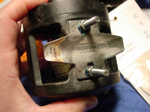

i received a box of reels from a local party boat captain several weeks ago. he tells me he bought 30 of these all at once. i don't know how old they are, but he says that are all acting up.
now, remember, these reels live on the backs several of party boats in northern california. one had a main gear shaft that had seized up so badly that you could not turn the handle. i was lucky this time. i left it in the ultrasonic cleaner overnight and the next morning was able to pound it out. the last time i tried this, i broke the side plate. and all the rest of the handles had no evidence of grease at all! what really concerned me was the right main side plate bearing. four out of five of these $15 shimano bearings were rusted tight. again, not a drop of grease to be found.
so check the bottoms of your reels, gentlemen!
sorry about the bad news......
Quote from: sdfishkiller;640404Fakes? or Japan is using Malaysia like USA uses China? Either way=crap!
i only know about these 5 reels. i am concerned about this captain's remaining 25. if everyone chimes in and says "NO WAY," then we do not have a large scale problem. this post went up on 29 websites. i will know more later......
Quote from: AKSalmon;640407I see these problems on a huge majority of the TLDs and Charter Specials I see in my shop. Almost all of the Shimano pre-ARB pinion bearings need to be replaced; only occasionally do the spool bearings go bad. This is not a problem of just the Malaysia made reels. These problems crop up if the reels are not serviced annually and water gets inside. My guess is you'll find water stains on the drag washers too...
actually, bill, you can see the drag washers in the photo above. no water stains at all!
