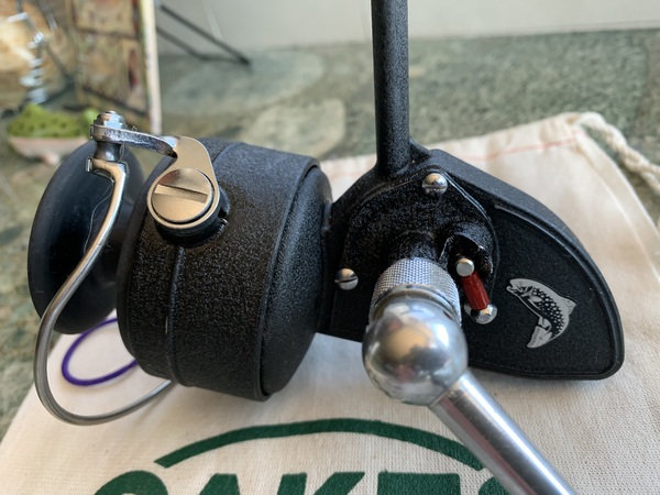

PacRat
Got 'er done today. Thanks for all the advice. Gave me a good excuse to fix my small torch. I used a combination of heat, prying, and tapping with a plastic hammer. My anvil was a deep socket on a 1/2" extension in the big vise. Pre-heated the frame as well as all my tools because they were icy cold. Started out with it hose-clamped with a leather pad on the good side, then squeezed it around the socket but couldn't get it ironed out as far as I wanted. Then I slid the bad foot off the socket so that I could slightly hyper-extend it a little and let it rebound. Inspected and re-heated between each stage. I still wanted it to go a little further so I turned it around and clamped by the bad foot and gave it some hyper-extending tweaks (small ones). Turned it around again and clamped by the good foot, then used a plastic hammer to tap the corners down a little. Then decided to quit before going too far. It fits in the rod clamp now with no problems. I appreciate all the advice from the Ohana.
Great job, Mike!
And thanks for the photos —- plus the explanation.
