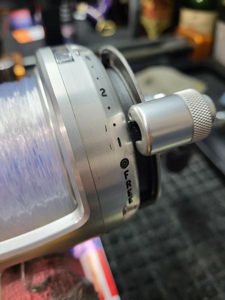

says kyle, "i just bought a new penn visx 16!"
says me, "very nice!"
says kyle, "i want you to set it up for 100 pound."
says me, "um, yeah.  maybe.  um, not really.  it's more of an 80 pound reel."
says kyle, "let's try it anyway."
300 yards of 100 pound jerry brown hollow patriot.
as requested, a 100 yard topshot of 100 pound mono.
setting the drag to 40 pounds at full gave me a 30 pound drag setting at the number 1 position.  no bueno.
out comes the cam.  it was ground down to a 3.5 degree angle.  here is the result.
and done!
still not a good idea.  just because you can do something, it doesn't mean that you should.

well, in all fairness to kyle (that really is his name!) the reel should hold up under those pressures.  i do have to admit that i did not know that the reel would achieve those drag pressures.  it was quite a surprise.  as long as the limited line capacity doesn't catch up with him, he should do fine! ;D

Quote from: alantani on December 23, 2022, 04:32:47 PMsays kyle, "i just bought a new penn visx 16!"
and done!
That's exactly how I want my new VISX16 setup...
Cool
Here's a 30 visx. Better this way!
700 yards of 100 pound Jerry Brown hollow,  a 25 yard topshot of 100 pound mono, 30 pounds of drag at strike and 50 pounds at full.
The 30 is looking muy bueno. The 16 with 100 yds of mono over 300 yds of spectra is WTF!
