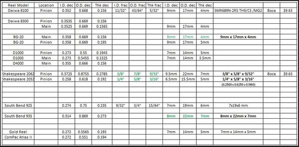

I have a method for determining unknown bearing sizes, then I put them in a spreadsheet for future reference. I haven't done it in a while but I'll explain as best I can. I measure in mm, decimal, and fraction. I put these in three columns per bearing. If one isn't even close to a normal size I just ignore it. Then I start searching for the closest bearing available at that size. A few thousandths usually works within the manufacture's tolerance. Sometimes it will surprise you what fits. Like Japanese reels with fractional bearings. I'll look for my chart and try to post it.
-Mike
PacRat
Here's my chart. This method hasn't failed me yet.
