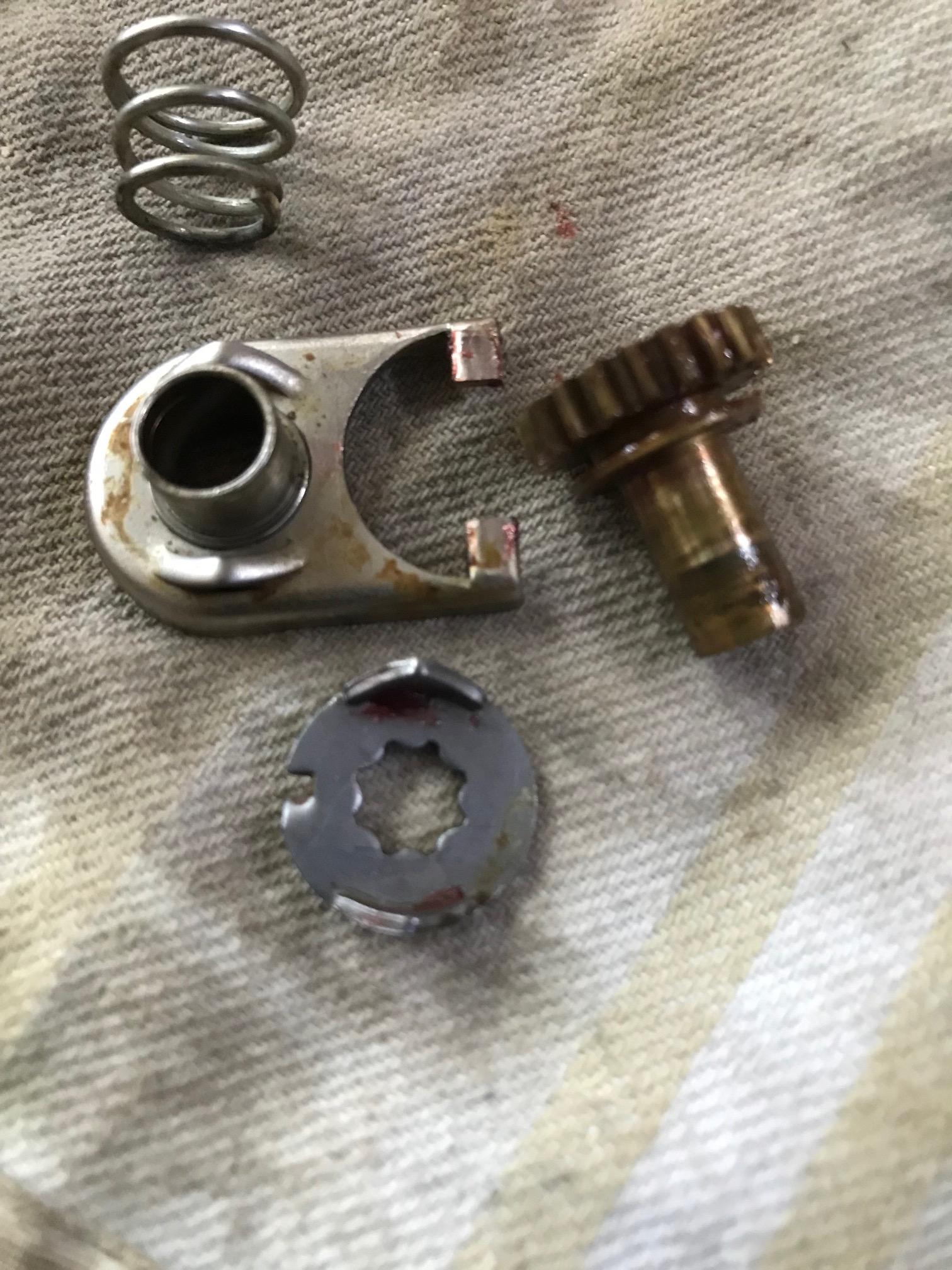

    Pick up the clutch and pinion .  Some notes here are the bottom cam plate under the clutch assembly has a tab that is in the slot of the side plate .   The other is the pinion has internal splines that mate with the spool.

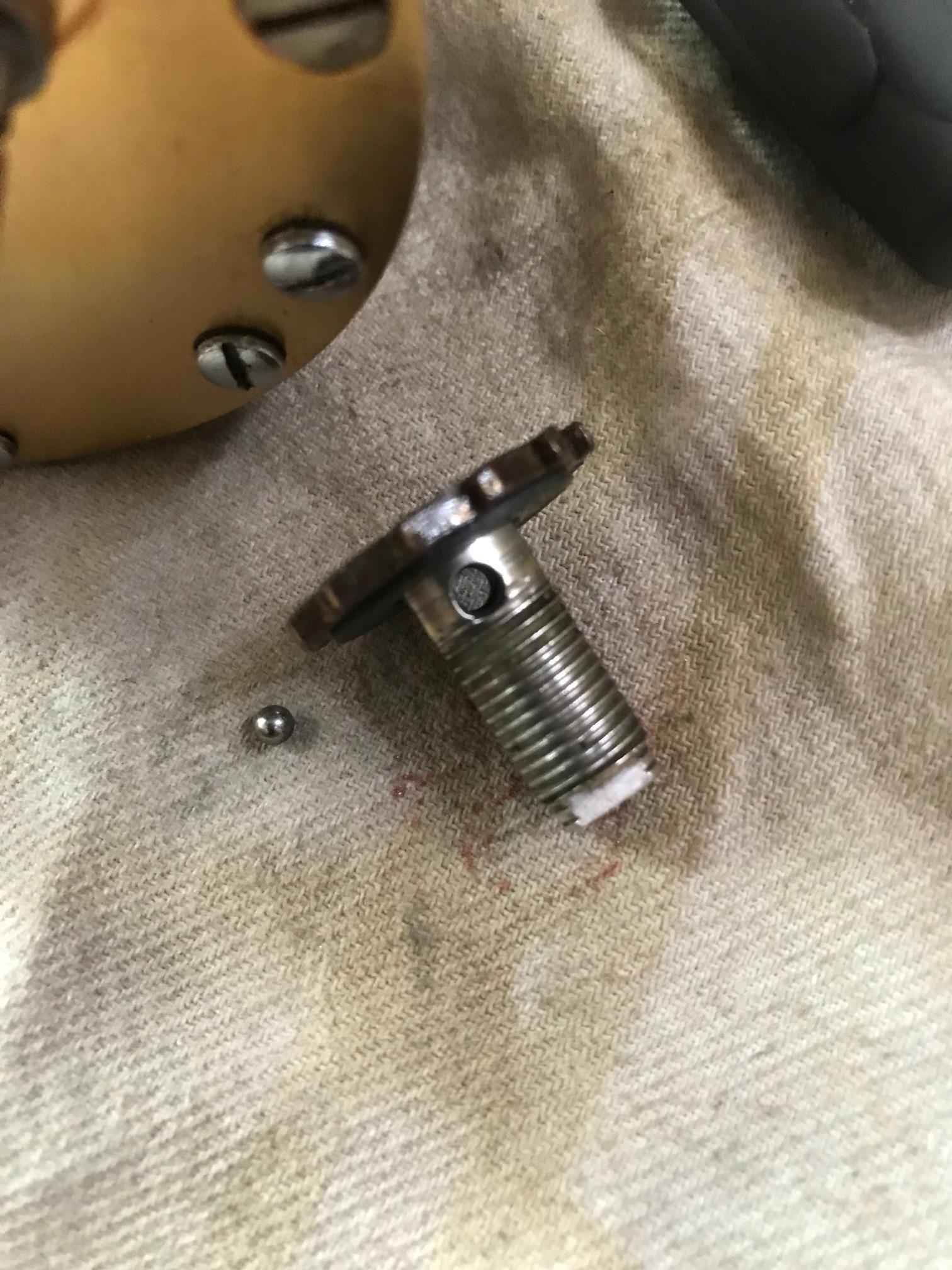

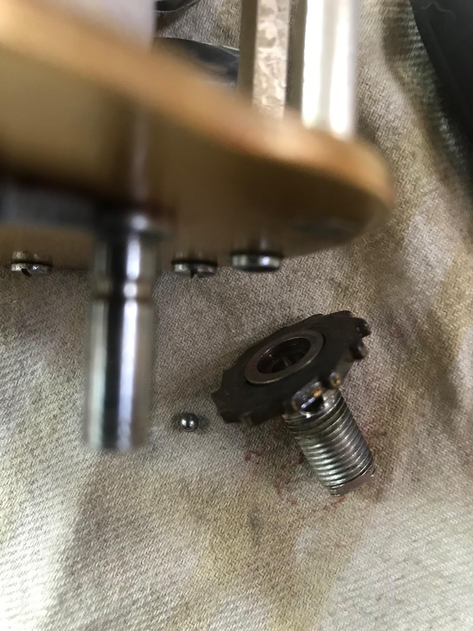

     I will make A note here about the gear sleeve .   It has a ball bearing at the bottom , that the gear covers up .    So when removing the gear from the gear sleeve it may roll out .   Most likely it will stay in place because of grease .  Another note is there is only one ball bearing  ,not two .
