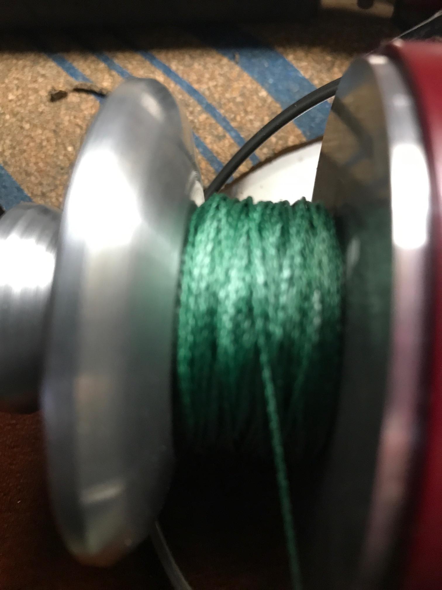

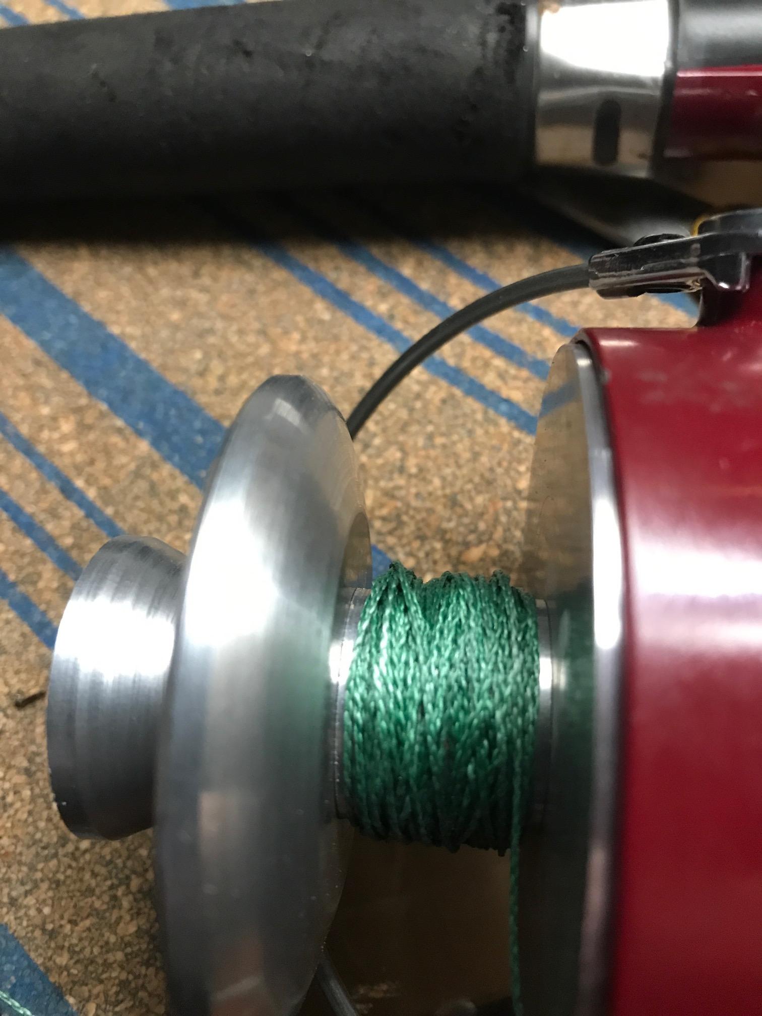

      I wanted to try something a little different in drag set up .  I want to try a two friction set up for starters , with possible adding another friction on the top if needed .   A shallow well,but very wide on top with more bearing stability in the middle .   I am going to build it with flat stock ,so I can change pieces if I need to change the design any as I go along .
     They were scrap 3/8 thick and 1/4 thick square pieces that I turned round .
   The 1/4 plate is the bottom drag plate with a recess to lock in the spool spindle  2.500 in diameter for the first friction.  The spool base has a cup cut in the bottom to match .    I am using .070 cork for a friction so I can work out the numbers as I go along .
    The top plate has a well .200 deep and 1.800 in diameter . Another cork friction and a.060 stainless steel key washer under the drag nut
The center section is .730 long to start with ,and .865 diameter to start with . This may change to fine tune line lay and yardage .   A center tube full length for the bearing
First test for spooling line .
I did not put tension on the line when I tried it for the first time .  I think I am close , I want to try some other line before I make some adjustments .
ExcessiveAngler
Would that braid, just happen to be Hercules?
Looks a little heavy too. Not sure if it's just the camera doing if?
But darn, you got some mighty fine machining skills there, brother!
That spool looks incredible and turned out awesome. Makes a guy envious lol.
