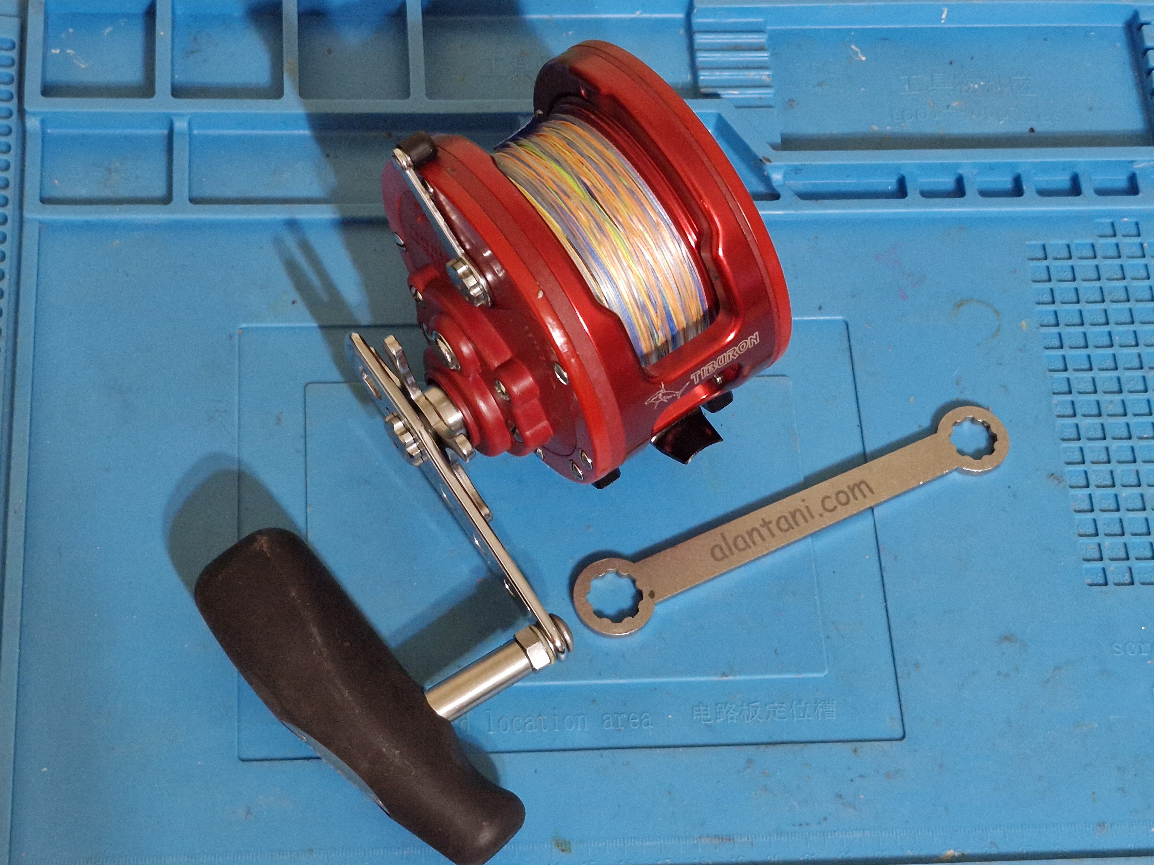

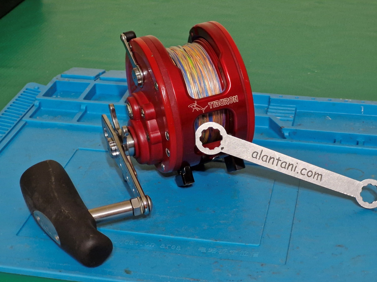

well, finally have time between rod / reel repairs to go through some of my personal reels that needed attention.
as is the case of the 114h XN
I installed the SS complete kit that I got from Jason (in the 1st page)

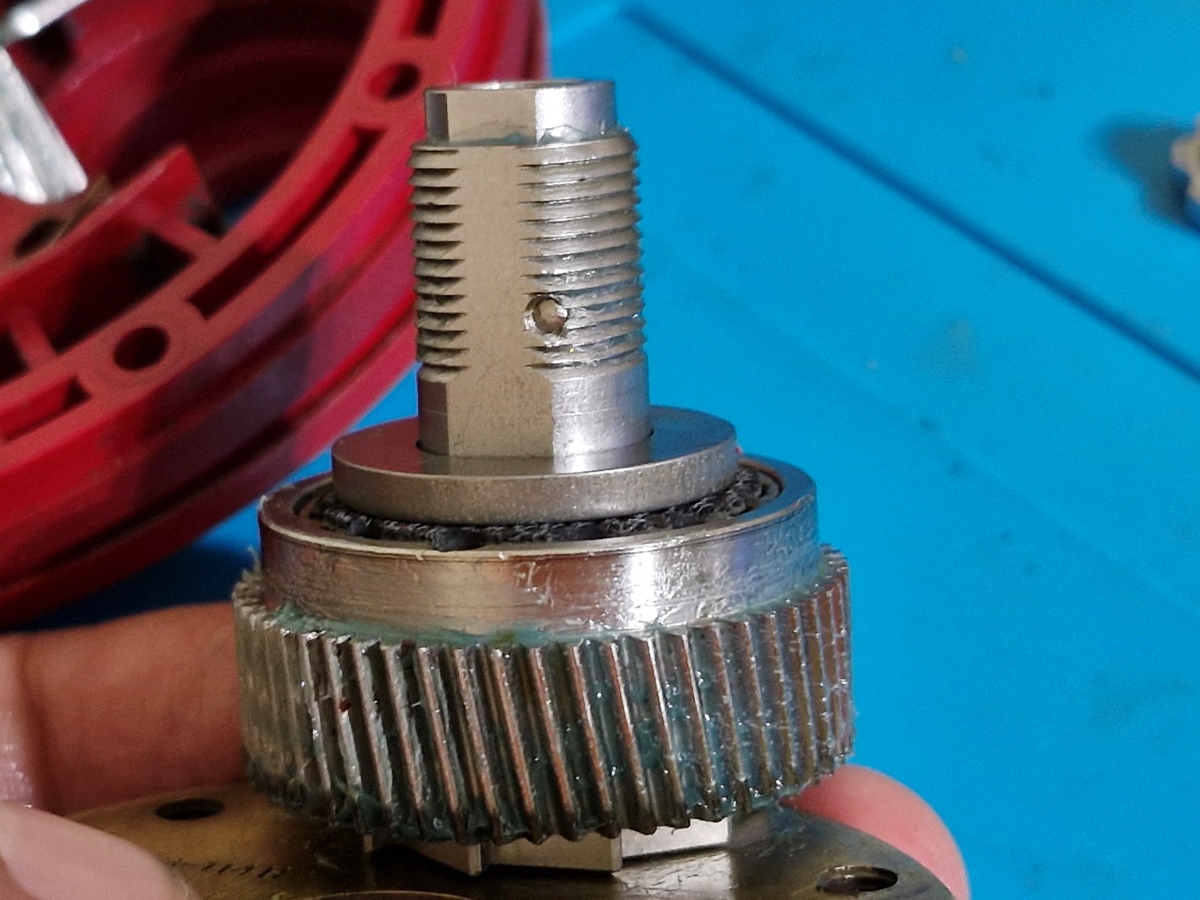

I couldn't fit the 6 drag washers that came in the 3 sevens insert kit, I read some posts he made on his section that he offered different thickness in drag washers and keyed metal washers in case someone had any problem fitting the 6-drag washers on the adapter of their main gears but of course that is not an option anymore with Adam no longer working on his adapters/parts, well I ended up installing 5 keyed metal washers and 6 drag washers, the 6th drag washer is just there as Double drag washer (mostly as spacer) just before the last thick metal keyed metal washer
as you can see there is no room for another metal washer because the last drag washer wont fit inside of the adapter

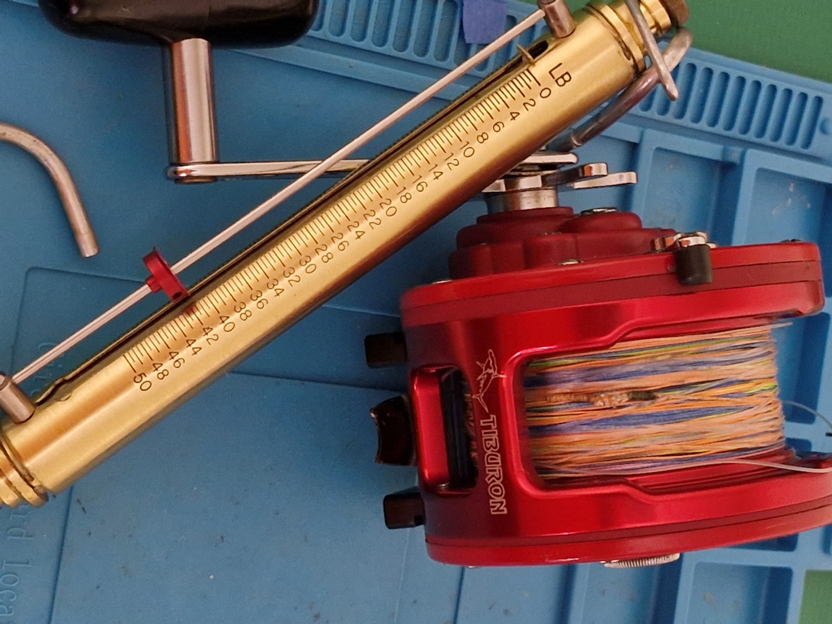

even like that I could reach 42# drag with that setup, I had to use my both hands to pull the line from the reel with the scale to be able to reach 42# and Im pretty sure I could have reached more but I didnt wanted to tried and hurt myself if something broke while pulling 50# drag directly from the reel, so I stopped there, in the real world I see myself in problems if I have to be on a Tug-o-war with a big fish pulling 40# or more of drag, so, Im happy with the reel as is, I dont think I will try to install the 6th keyed metal washer later but is good to have the option if I find some thinner metals, but I dont promises anything.

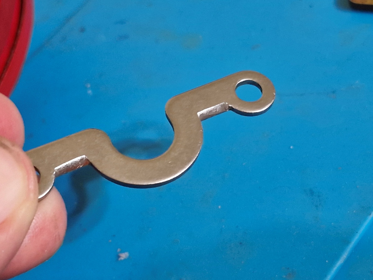

I filed a bit on the edges of the yoke to have an smooth transition with the eccentric Jack when moving the lever to activate the freespool to drag, it was kind rough before but now is an smooth operator !!

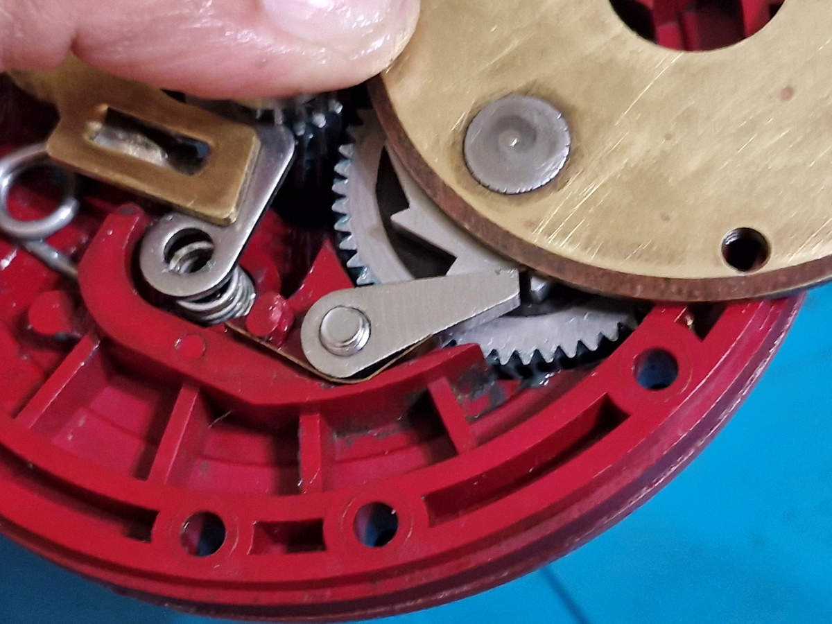

I also installed a 2nd SS dog, nothing new here, so move on !

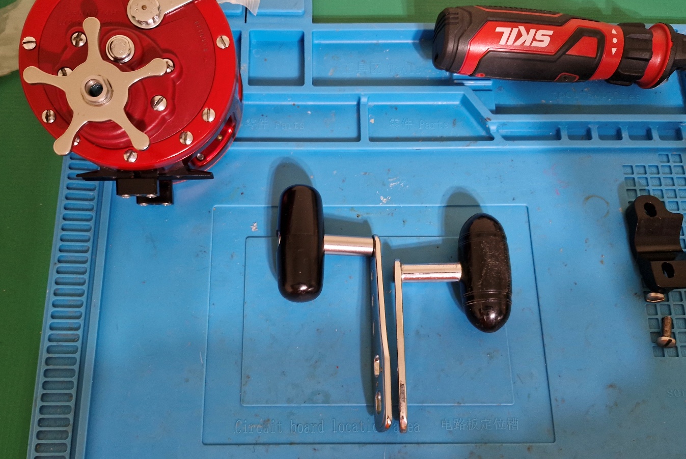

lastly I have a brand new daiwa sealine 600H handle with the blade much longer than the stock 6/0 handle and it fits perfectly on the 114h SS sleeve, but the knob was so small, so I drilled out the stock knob and installed a VISX handle knob, its too heavy for my taste but it was the only handle knob I have on hand that fit the 8mm hole on the handle, for know it works
and thats it, its ready to get some fish on the Panga

Looks great Alex! Do the dogs alternate or are they simultaneous in operation?

Quote from: sabaman1 on November 14, 2024, 05:27:24 AMLooks great Alex! Do the dogs alternate or are they simultaneous in operation?
they're simultaneous, I was going to go with an alternated dogs but since this reel has a 10 teeth Sleeve the backplay on the handle is not that bad.
