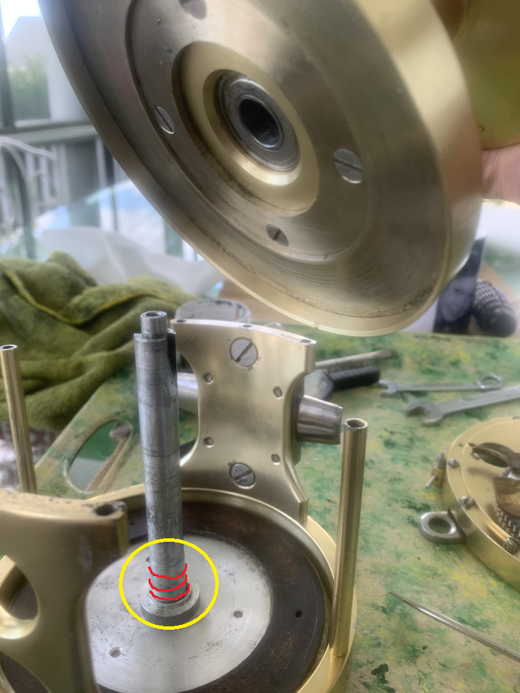

I have this 9 fin nor I am putting back together. I have followed several schematics and think I have it right but obviously don't. The reel won't turn and sounds clunky if it moves at all. I included some pics as I was putting it back together. Maybe one of you can pick something out I am either doing wrong or perhaps a piece is missing? Any help? Thanks. Tom

It looks to me like the reel's missing the spool thrust spring, which sits between the drag plate and spool bearing, eg:
(Excuse the bad drawing!)
Without the spring, the drag plate sits against the spool and prevents rotation.
Hope that's of some assistance.
Let us know how you get on.
Good luck, Justin
