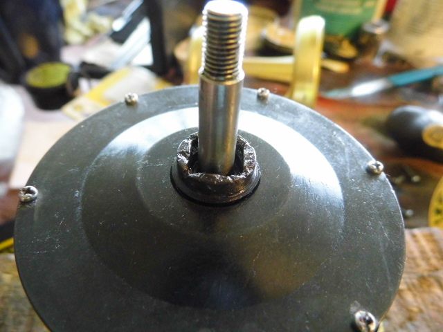

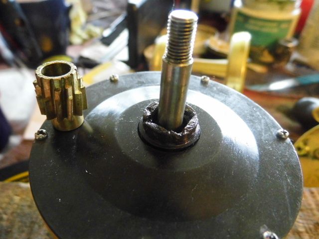

erikpowell
UPDATE
Well since Alan recommended a call to shimano for awie, that's exactly what I did. A switched on guy there named Isreel pinned it down for me.
The set nut in the sideplate looks like somebody took a pair of pliers to it... probably because they tried to pull the spool out from the left side and tried to loosen the nut thinking that would remove the spool...
The spool cannot be remove via the left side plate on these reels.
There were burrs on the nut and those burrs were catching the cam & not allowing it to release for freespool.
I tried to file the flat edges back down to maintain the shape of the nut, but it was too far gone.. it's rounded off at the top
Someone's previous entry into this reel has trashed the nut
The fix will be a new side plate and cam assembly (even though Isreel says the cams are more durable than the nut) I'm not taking any chances, i'll replace both.
New side plate = $115 USD
cam assy - not sure yet
Hope this helps some folks out!  Cheers, Erik
