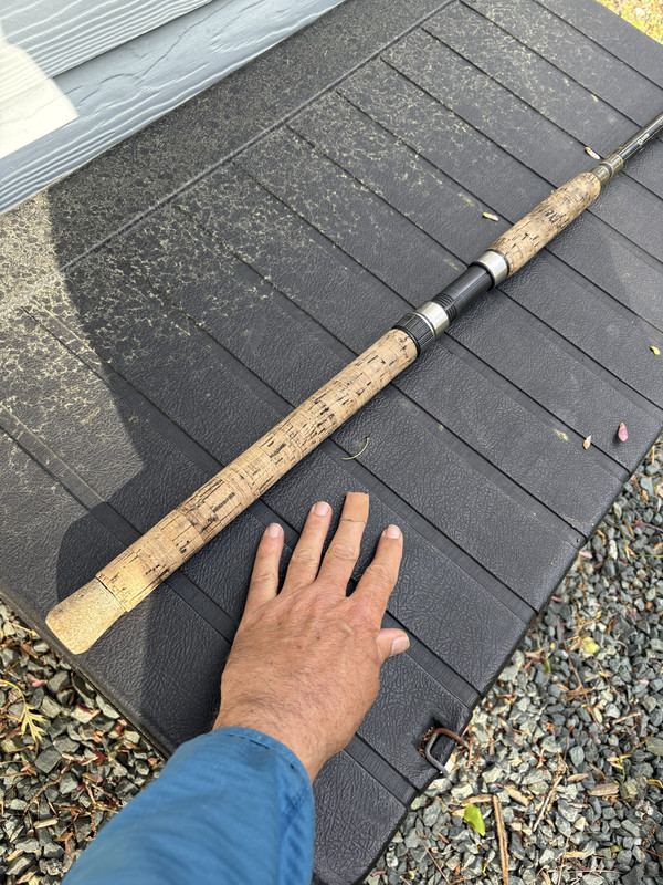

I have not used this Quantum 7'6" MH since I got rid of my boat 10 years ago. Now I exclusively kayak (or surf) fish and find the long butt unwieldy in the kayak. Is cutting a few inches off a solution? If so what is the right kind of saw and how can I finish the end? It's a broomstick of a rod for a MH but might serve me well for some sheepshead, black drum or Cobia fishing this year.
The butt is also really thick - I assume it's a thick cork grip glued on? If I cut the butt can I possibly finish it more like my St. Croix Mojo series that has a split grip? I have saws (+bandsaw), e6000 adhesive, sandpaper and bandaids.

There's a dozen viable options here. I'd try to keep the butt cap, it's nice. I'd decide how much you want off, and cut that much off above the butt cap. Then peel the cork off the butt section you removed down to the butt cap then carefully cut down close to the butt cap. Then find a dowel rod that matches the ID of the top section that you're keeping, cut a short section and glue it in. If you're lucky there won't be a difference in ID between the two but if there is you can wrap with thread. I'd use 5 min epoxy. I hope I did a decent job explaining that.

First pull off the butt cap just to check and make sure the blank extends all the way through.  Use a fine tooth or diamond edge hacksaw blade and cut a little at a time going all the way around the blank so it doesn't splinter right at the end of the cut.
