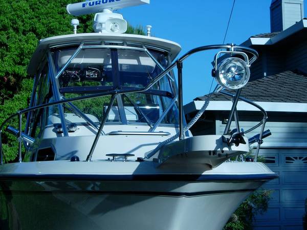

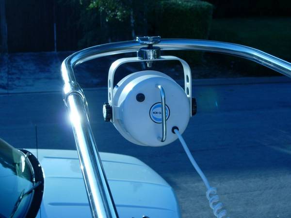

ever since i was a little kid. running for tuna at 4am can be just as bad. you never know what kind of monsters will jump out of the closet at 20 knots! i used the clamp from a perko rod holder to bolt on the head light. there was no room on the hard top, and i wouldn't want a light up there anyway. it would light up the entire bow.....
so i mounted a blue eye deck light on the bow rail using the clamp from the rod holder. i actually dumped the 400,000 candle bulb in favor of a 1.2 million candle bulb....

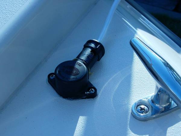

the electrical connection is a left over scotty downrigger plug that wired to one of the extra switches on the main panel.

Wont the light take a massive beating up there????   :'(
WOW!!! WHAT A RIDE!
Ness,
    As long as it's ip67... he's good to go... if not, use it until it quits and hope it's not the first ride out  ;)
Nessie Hunter
Quote from: broadway on June 27, 2012, 02:41:49 AM
Ness,
Had to look it up.....   ;D    ;D
That only says it relates to;
6 = Dust protection
7 = water immersion
I would be worried about the Shaking and slamming damage????
At 20 knots that could be a big problem???
WOW!!! WHAT A RIDE!
naw, it's held up fine.  it's cheap, also.  had it for 6 years and noticed that the housing has a small crack in it.  i will get it replaced sometime later this year.
