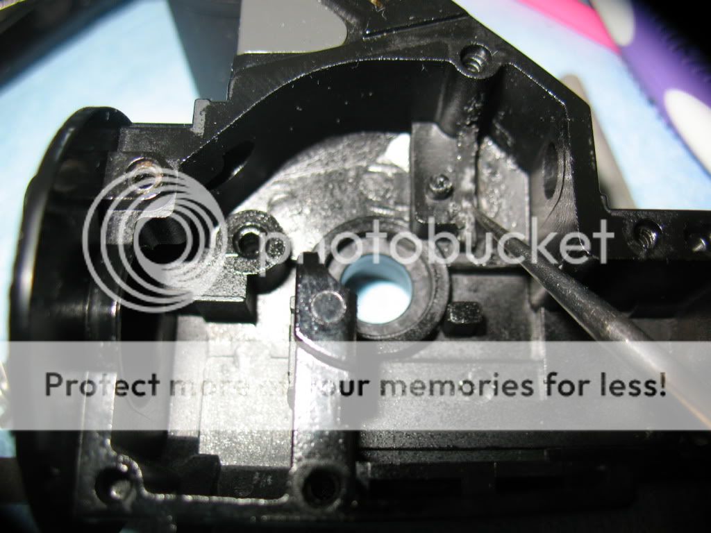

Hey Guys,
Wondering what type of bonding agent to use to glue/bond a small internal piece of graphite that broke off in my spinner main body housing.  I've thouroughly cleaned/degreased the housing.  Ive tried CA/super glue with poor results; so I was thinking of wire-brushing a new rough surface (and remove the old super glue) then using "JB Weld" aka "my magic glue".  Any suggestions for a bonding agent for graphite?

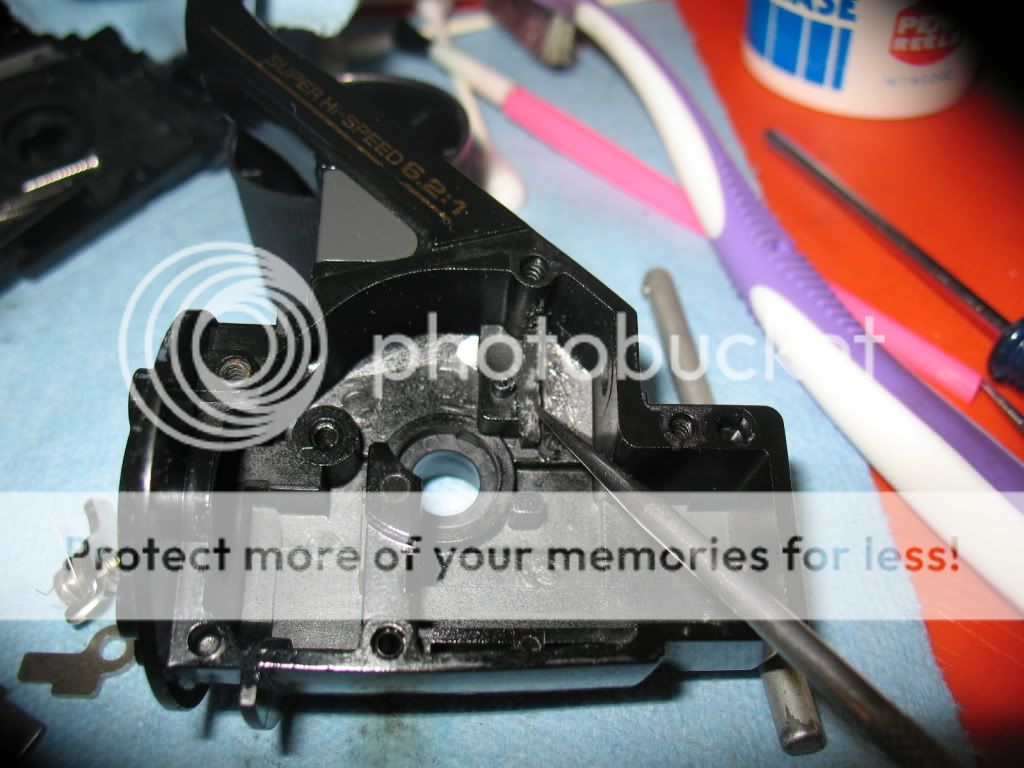

One way or another Im fixing this reel.  I purchased it a couple of decades ago and is only used by guests. The tip of the awl is pointing to the damaged area, the other photo shows the broken piece and the two other parts that are associated with the repair.  The long shaft actiuates the spinners anti reverse  and the copper spring adds pressure to the shaft.  The spinner is a Daiwa PR1605H.  BTW Sal, Im just lucky taking pictures w/this camera (you wouldnt believe how primative it is, it was a salvage gift) but I seem to get it to work for me.
Sal, here are the photos:
A closer view of the body:
The three associated parts:
Don't get rid of that camera Leo, it takes some nice pictures. About the reel, I thought it was going to be a small piece. I've repaired reels in the past by drilling a small hole and gluing a piece of copper wire it the shape that I needed it to be and it always worked out. Your damaged piece is a little trickier, but, it des have lots of area to make contact with the  glued, you just need to find the right glue. After seing what you have done with those plier, I have no doubt that you can fix it. Good luck! Sal

a gob of jb weld should do the trick. clean off the old glue and rough up the areas to be glued a little with sand paper.  good luck

Leo:  The piece that you are going to repair does not look like it will be stressed.  If anything the shaft that will sit in the indentation will not put any side pressure on the part.  I vote for JB Weld.  It looks like there is room on the sides.  I would build it up on the sides to give it more stability.  Go for it.  You have nothing to lose.  Dominick

            It looks like you may be able to brace that piece from about the awl point to the outside of frame on right.
           Can`t tell what caused the failure , it looks like just a pillow U groove for shaft that goes to the right outside frame. Are   forces acting upon that piece from L tO R or vice versa ? I would not think there would be,but can`t tell.

Are you sure it's graphite?  Hard to see clearly, but looks more like an aluminum alloy.

JB Weld was my first thought and I will go with it.  As stated I will rough-up/clean the area then build-up the right side for security.  I'll then Dremel to shape.  Its not a load-bearing/pressure point as stated.  I was the cause of the break in taking the reel apart (too much force).  Sal, Im not getting rid of the camera (had to fix it and bring it back from the dead when it was given to me).  Didnt know JB factory in SoCal may check it out.
