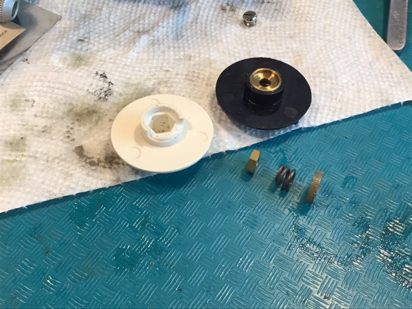

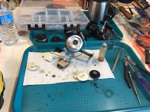

Does anybody have a break down and pictures of the parts that go inside the white drag knob? I believe there is a spring, a nut that threads onto the shaft to tighten and loosen the drag and a round piece with a shoulder on it, so 3 pieces all together or is there more parts inside the white drag knob?
#29
No, that is all there is FH —
From the inside out — Brass nut first, spring next, lastly the brass collar.
