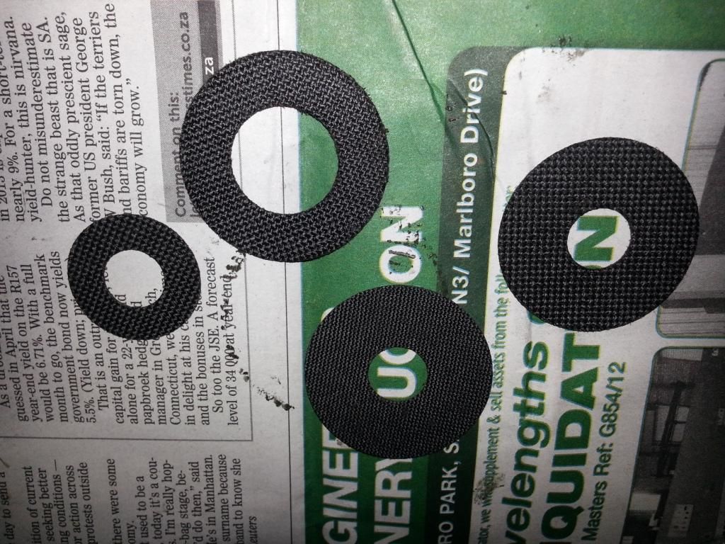

Thanks for all the helpful insights, I have now added a washer and will see what it does this weekend. It is much stronger, there was only 2kg of drag, think it is up to about 7-8 now will measure after I filled up with line later. Hopefully it doesn't bum out again, thumbing the spool is not funny after an hr. I mailed Dawn the measurements and it seems like it is particularly the washer below the main gear that has compressed the worst.

My concern is that why the washers are not lasting, mates of mine have had there washers in longer and they have had more abuse and they are still going just fine. Attached is a picture, I cleaned the grease off though, but they looked pretty flattened when they came out.

They don't appearer to be damaged, just compressed, do you have the thickness of the Dartaniun II washers?
I'll assume your star is hitting the sideplate and not compressing the drag stack sufficiently.  Try to get an extra keyed washer and put it on top of the stack for a spacer or put 2 CF washers under the top keyed washer.
Your washers look fine and the thickness seem to be fine as well.
What are you using to lube your ARB?  Is it possible that oils are getting into your drag stack making it slicker?
