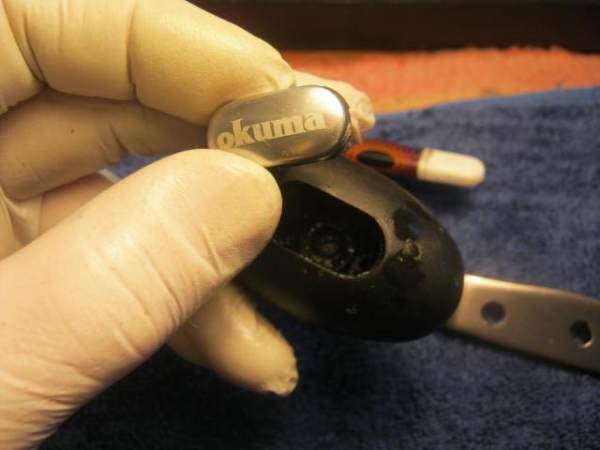

A 10mm spanner will get the handle nut off - no special tool required...
Don't forget the plastic washer under the handle nut.

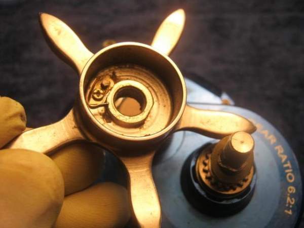

There's a small clicker assembly within the drag star.
The first belleville is oriented thus (, ie curving towards the reel frame.
And the second ).

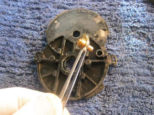

The silent Ambassadeur-style A/R dog pivots on a post the sits in the side plate cover and also fits into a hollow in the side plate.

Here's the A/R dog and post.

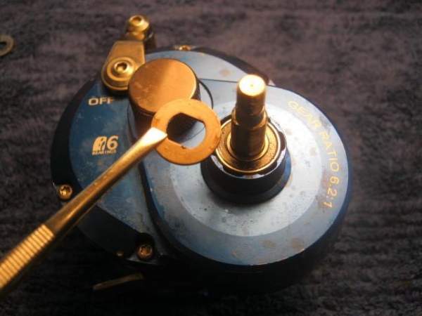

Don't forget the plastic washer under the clutch lever.
And now for the clicker assembly...
Once again, being clear, the plastic washer can be easily missed.

Here's the plastic washer back in place.

This is exposed to the elements, so is fully packed with grease and was also soaked in Inox prior.
The A/R dog should be gently fitted to the A/R ratchet before fitting back into the side plate cover.

Nearly there now. Add the first belleville with the curve facing upwards, ie away from the bearing.
The second should curve towards the bearing, ie ().
Grease and lube the handle shaft and bearing.
