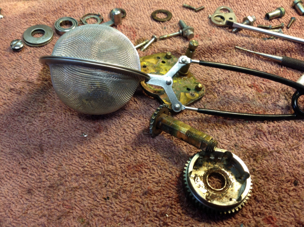

The mesh balls are made for loose Tea. Ask the Wife she might have one already. I use them for spices when making soup, fill them & never have the spices floating in your soup again.
Aiala
Great idea guys, you could clean parts and have soup at the same time ;D...good stuff!
Hmm, funny -- doesn't taste like Miso Soup.
I have used those for years for small parts in the US cleaner -- they are quick, efficient, and just rinse out with fresh water -- dump on a paper towel -- clean and done.

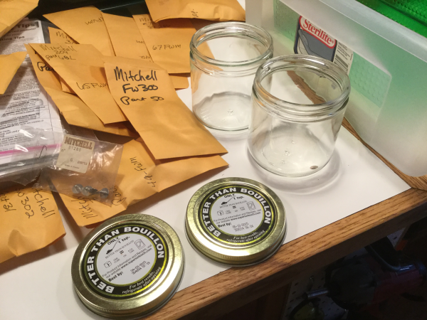

Today is sorting and organizing a bunch of small Mitchell parts into envelopes -- day.
Wife came up to the shop and asked if I could use these jars -- they will be great for solvents, greases, soaking in mineral spirits, etc.
They are a type of bouillon substitute we use for a lunch with a sandwich or crackers.
Perfect size jars -- wide mouth -- 3.5" wide -- 3.75" tall -- good metal lid with a gasket.
Fred, if they are glass you can run into a problem if you shake them a little with metal parts in them. Been there, done that, and had the bottoms fall out. What a mess. Plastic is better. The glass jars are better for storing screws, washers, & nuts. Screw the lid to the bottom of a shelf & screw the jar on. No lid to lose & easy to see what's in the jar.    Rudy
These will be used for solvent soaking prior to Ultrasonic cleaning, Rudy.
Agree with the breakage issue -- just do not shake them too hard -- let the solvents do their work.
As for small screws and parts -- got way too many for jars -- they all go in plastic bins or categorized parts envelopes in cupboards -- by part number.
I too, have broken jars on 2 occasions -- try not to do that as much anymore.
