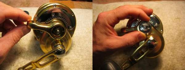

So let's begin by removing the handle nut plate plate screw #001 and handle nut #2417 by using a small phillips head screw driver and a 10mm socket.
Remove the friction washer #799, star drag #2472, star drag spacer #1289 and the two drag spring washers # 0015
Loosen the three right side plate bolts #1698 and pop off the right side plate assembly.
We now have the reel in three sections.

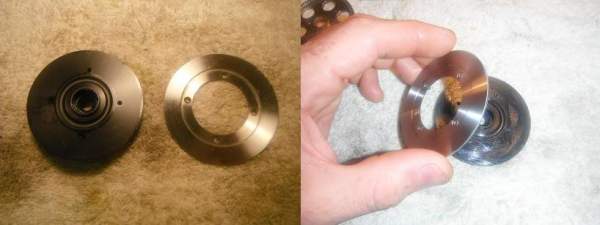

Ok now it's time for the right side plate.
Remove the two set plate screws #689 hold the two pieces together so that nothing falls out of place.
Here's a shot of the inside.
Pull the roller clutch tube #2774, remove the drive gear #1425, key washer #2477 and the anti reverse ratchet #2478 and clean every thing up.
Drag washer (a) #1214 size: OD 17.99mm ID 8.13 W 0.95
Drag washer (c) # 2567 OD 25.50mm ID 16.80mm W .99mm.
I was not able to uplode the width picture???
Apply a light coat of shimano drag grease to both washers.
Remove the pinion gear #1587, the two yoke springs #1133 and the yoke #248.
Clean everything up with a Q-tip and apply a light coat of shimano grease to the clutch cam retainer, clutch pawl and clutch plate.

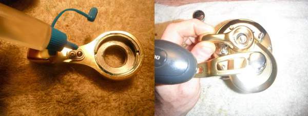

Apply a light coat of shimano drag grease.
Apply a light coat of of yamaha grease on the right side plate. add a couple drops of oil to the roller clutch bearing #2396 and the cast control bearing #194.
Cast control bearing size: OD 10.00mm ID 2.95mm W 3.99mm.
was not able to upload the ID pic. sorry.
Bring the right side plate and set plate housing #2571 together, line up the two set plate screws #689 and tighten it down.
Drop the spool back into the frame.
Push the clutch plate down into the free spool position and line it up with the frame, next tighten up the three right side plate bolts.
Okay were almost done, place the two spring washers #15 in this configuration (). next the star drag spacer #1289.
Replace the star drag #2472 and the friction washer #799.
And finally the handle and handle nut #2417.
