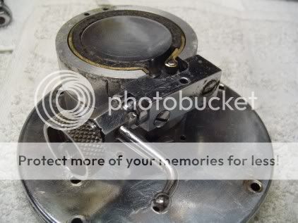

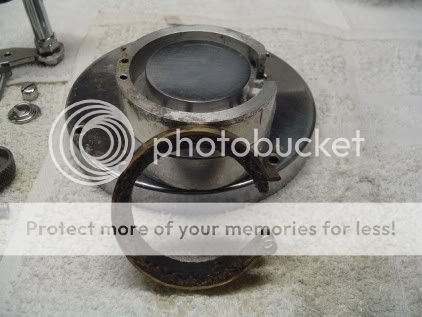

Robert Janssen
It is not my reel, but inside they look pretty much like the patent describes.
Picture Credit: Mike Cass of ORCA
