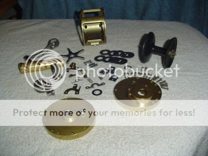

Moving on with the saga. I think in order for me to make this happen while we are all still young   ;D, I have to determine what is available in the real world verses the future idea world. I figured I am coming close to exhausting after market parts at this time, so I made up a list of what I feel may work in this Accurate head plate for this build, but since I am kind of new at this, I wanted to put my list of stock part needs out here to make sure I have it kind of right before I get into the actual assembly of the reel.
What do you folks think about these needs? Will these parts work without altering the Accurate Head plate. I really do not want to modify the plate to get this done.
All constructive criticism is appreciated. Puns are enjoyed.  :D
After going through some of my old junk I came up with yoke springs, a bridge screw set and a complete set of drag metal and carbon composite washers with the spring washer. So items 5, 9 and 10 are now collected.

OK, I am back. My source list has grown and I am sort of ready to start the assemble process. Tomorrow I will go to the tackle shop and grab the odd and end pieces I need to complete this project. My allowances for deviation are because some of what I want is not available yet, so I will use a stock bridge, jack, single dog and standard drag kit until I can get the Stainless Steel jack, double dog bridge and drag insert kit. I may also play with customizing a spool as my time allows but for now I have a great start:
Many of my sources names are very familiar on this website. I thank you all for all your help, contributions and great deals that have already happened and what is to come. We are not done yet.  :)
So, I have started some assembly. The tail plate fits perfectly. The precision of Accurate parts is amazing. Not even a hint of misalignment of any rim or fastener.
