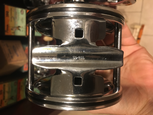

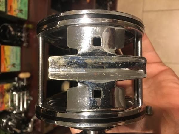

Long Beach 67 stand and posts. The 67 uses a 30-200 stand.  BUT for a early 50s 49A marked reel you must use the early 30-200 stand with the "squared" foot blades. The later versions have more tapered "blades".
Here are some pictures of the differences. The top picture is the stand on a 49A marked reel. Both of my marked 49A reels have the same stand.  The bottom picture is the stand of a later wide 49.
