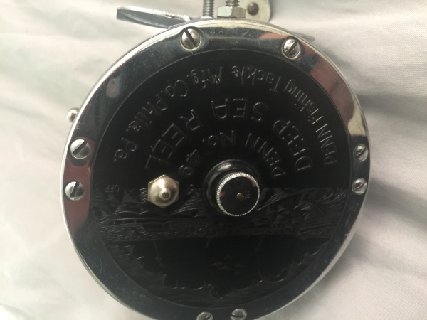

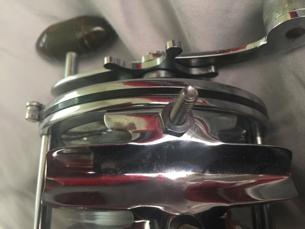

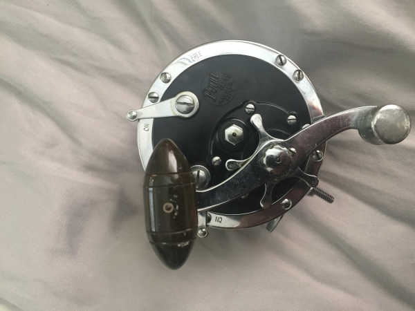

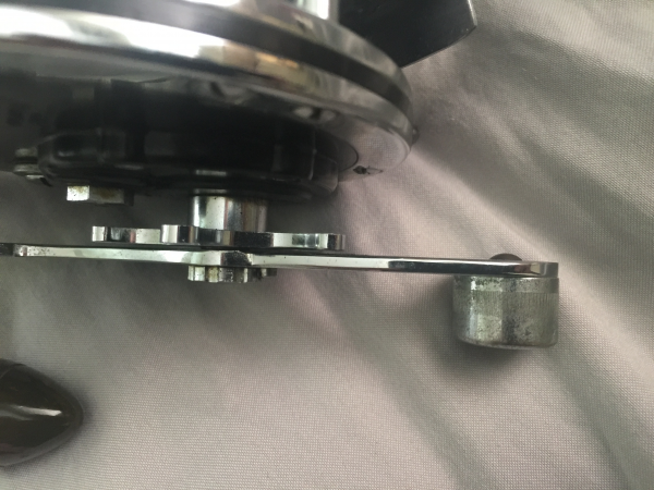

sharkman
Something keeps drawing me to this reel. Sold it and bought it back. There is no numbers on parts. The handle and clicker look different. It has chrome spool with diamond holes in it but if I remember correctly changed this out because was thinking about fishing. I have plastic spool which is spoiled with Dacron. Is the reel a shelfie or fish it
xjchad
Looks like a really early model.  Sure is pretty!
Husband, Father, Fisherman
sharkman
#59
Thanks xjchad. This is where I want to put the spool you sent. I have another that I am building.
