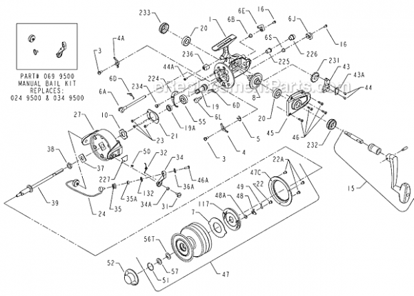

Hello All,
Please help! I have a question around a weird noise I'm getting from my reel... I just, for the first time ever, dis-assembled, cleaned, re-greased and oiled, and re-assembled a reel. It was my 3rd Gen Penn Spinfisher 9500 SS. Its an old model but only been used maybe 6 times. After servicing with the help of a YouTube vid, I noticed a slight grinding noise as the spool floats to its lowest place on the rotor. When the spool is removed, the noise does not occur... Additionally I noticed that the noise doesn't occur if reeled upside down  ??? ... I am hoping that it is not a bent shaft since it has barely been used and was not doing this before I serviced it...
Does anyone have an ideas as to what could be causing this?
I posted a few YouTube links of vids of my reel. You can hear the grinding pretty clearly.
With spool:
Spool off:
Thanks in advance!!!
- Matt M.

Matt,
That noise sounds like the spool hitting the rotor at the bottom of the rotation. Tighten the drag knob and see if it still makes it.
There should also be a Teflon washer on the spindle that the spool sits on.
Check the inside of the spool and the rotor where it might be contacting.
The spinfisher spool wobbles a bit until the drag is tightened down.
No Teflon washer on that one Daron, but a metal shim there would cure the problem. Good idea to check other parts first though.

Welcome, Matt --
As has been said by Sal and Daron, there is no teflon shim washer on a 9500SS -- on most spinners, this would go on top of the spool shaft -- and the spool would rest on it.
As Sal said, you can install a thin metal brass washer under the spool, where the spool rests on the spool shaft.
However, if this cures the issue -- there is still something amiss that was not there before you serviced it.
From your description, it almost has to be a rubbing problem on the underside and inside of the spool.
There is a drag assembly there, along with a shield and some screws.  If any of this is out of alignment, or loose, or screws not seated in -- that may be the issue.
Basically, picture how the spool shaft goes up and down -- then check the crosswind block as Sal said -- because if this shaft is not tight and in place -- the spool shaft would be riding a little lower -- enough to cause the spool to scrape slightly on the inside of the rotating head.
How far down did you disassemble your reel?  Completely or partially?
Mattymo92
Quote from: foakes on August 03, 2016, 04:50:23 AM
Welcome, Matt --
Hi Fred,
Thanks for your reply. That makes sense. To answer your question, I dissassembled everything but the bearings and the drag system. So I guess really only the gear box... Sounds like I need to open it back up this weekend and double check that cross wind and make sure everything is sitting in there correctly. That schematic you provided and the step by step link Sal provided should come in handy :)
Thanks,
Matt M.

Matt, since you'll be there, make sure you check the pin on the crosswind gear as well, that gets lose at times.
