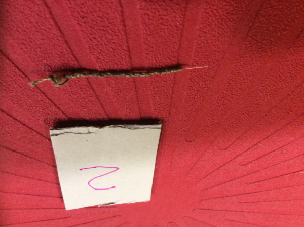

Ok I,m back with some more information on my FG issue.   Firstly I've stayed with this spool of fluorocarbon cause I'm not backing down from my learning curve.
   Shown below is a picture of my variation that seems to work.  It's not as smooth as before but it's gripping the hard finish of the fluorocarbon now.🕷

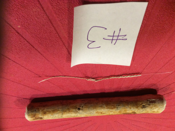

The difference in tying now is using two full wraps in the direction towards the mono tag end as usual and one opposing wrap pulling both spectra pcs as usual.   #2 shows another view after the extreme pull test.
Now for a little variable,  the white spectra is substituted for the aged tufline and this time the knot is left with a mono tail clipped long enough to see it at all times.  The russuto 5 wrap is left with a space for inspection.   This spectra was not scraped as some times before.   Using sticks to wrap and pull after finishing the tag ends there is no more movement.
   I wanted to show the pictures.   Usually a wrap in opposite direction is what the other posts say....
  The knot is not as smooth looking as the previous version but using a double wrap and a opposing single wrap something has changed with the grip and it looks like it will work.

I,m now going to strain the knot more after taking a picture 🤳 and see what breaks or slips.

Kinda funny looking FG knot? Are your wraps sliding a long long way down the fluoro when you load it or something? It looks like an FG that has fallen apart :/
