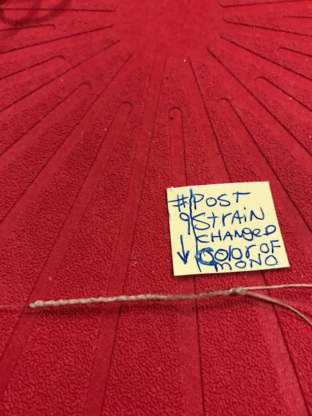

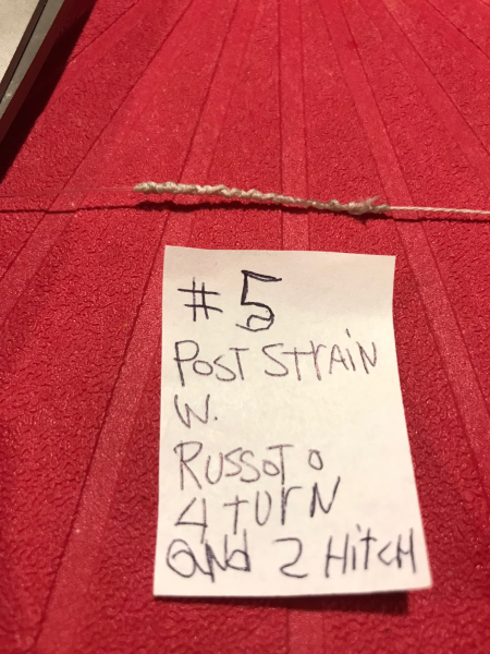

Ok, thanks for the ideas,  butt the method of wrapping twards the mono tag end using the main spectra of    two wraps under and over back towards you and one wrap over and back to the cross ☦️ seems to be holding good.   Here's a picture.
The knot is unfinished here, and with the half hitches 2 redy for initial tightening. Strained twenty pounds.  Seems to hold and noticed that the flouro has changed color twords the hitches.
Here's another.  Tied w two wraps twordsyou and one opposing wrap away.  Same as before.
This method is not as smooth butt it's holding,  notice the mono gets the burden.

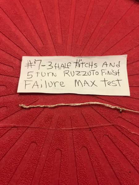

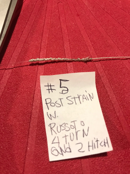

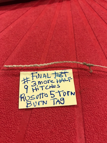

So now for the big disappointment that started this post.  Trying to keep everything the same butt using the single opposing wrap like shown in the many good videos .   Whatcha dis.
   Nice and tight of course.
The knot gets a double hitch and the rusutto finish.   Looks 👌.?
As before I was confident that this single opposing wrap method would be holding the maximum strain,   And it would let me down again.😢.  I,m still 🌊 searching butt my alternative will get me by.
   Any more thoughts.?✍️
The knot was wet when final tension was added.  It looks good and the strain was slow and steady.  It hold then we wants something to give.  About when I thought the mono would break it just started slipping and it finally collapsed.   There is no fish 🐠 story 👎🤬

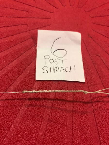

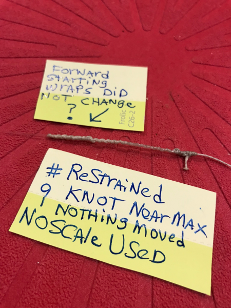

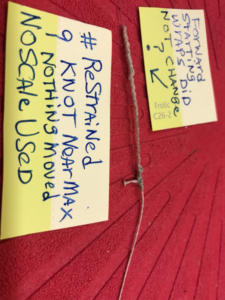

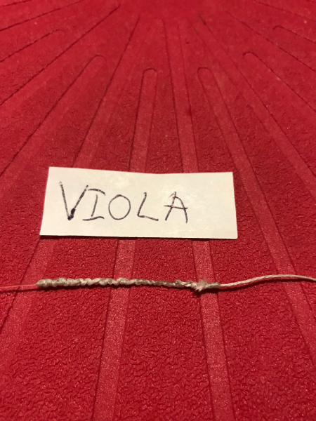

Thanks again for the 💡.   I,m not done, nor ready to give up.   Here's another try at the kitchen table.
   This was before I read today s post.  As before no tension just fingers to hold double towards you wraps and a single away from you wrap, using 12-15 alternate pairs and 2 half half hitches.  Shown below.
This knot shown changing colors seems to be squeezing the mono.
Today was agood day for the not tier.  Oar just a lucky moment?   I,m going to try again with the tension tag normal single opposing wrap method as I,m not at home where I wanna test these with a spring scale in parallel with my come along tool.   This to me gives me a linear quantitative control as pictures and or video will capture what gives.    Thanks again for everyone sharing your thoughts.
