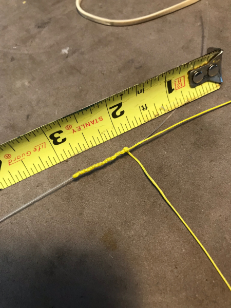

Another try at the knot,  using 12 cross pairs and one half hitch.  Before first strain.

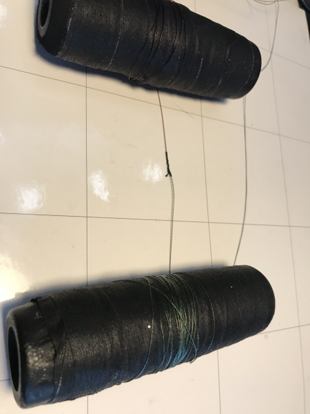

The mono seemed to immediately grip and tighten the wrap over it,  after the first tightening strain the mono tag was trimmed to about an eighth inch and alternating Hal hitches pulling it down.   It was retested and seemed to hold as I could not break it by 🖐 wraps on each end using these rodbutt line wrap helpers.
I feel like I can use the knot now and kinda like it and plan on using it for spin reels w braid.   Now more practice on the lighter lines. Thanks for everyone helping me.
    I,m sure there's others that are learning from this topic as well.   It's all here for the world 🌎 to see.

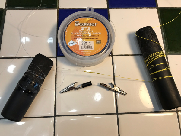

The last picture is of a handy device that I came up with to hold the tag end of the braid.  Clip it to the braid and your collar or shirt 👔.  Or what ever.   Just saying.    Because my teeth did not do it well.🙊

Looks good now!
Did you ever figure out what the problem was before?
boon
Much better looking knots (with the associated better results)!
Glad you got to a knot you were happy with.
Three se7ens
Much better looking, Gary.  You could probably drop a few more cross pairs without weakening the knot still, I typically do 8-10 cross pairs, which is a little easier to pull up tight.
Thats a tricky knot because the simplicity of it is misleading.  It requires more attention to the fine details, but once you get used to it, its pretty easy to tie.

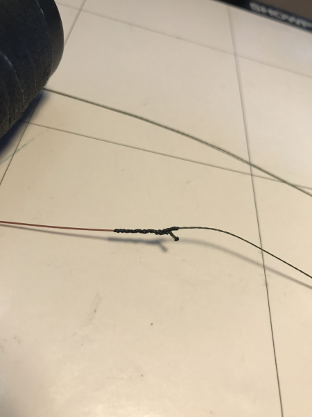

Thanks to you folks the fg knot is seeming to work for me.  It has its virtues and having good eyesight and finger dexterity sure helps.   I'm showing below a 10# mono leader and 20# braid from this morning.
    Another tip that works for me is wrapping cloth friction tape over the dowel or cutt of rod butt really grips the lines well for tightening the knot.
Three se7ens
I use a pair of 3/8" stainless rods covered in heat shrink tubing.  Not because its perfect, but its what I had.  And it works quite well...
This brings up an important point.  Dont even try to tie an FG knot without something to hold the line tight without cutting yourself.  This is a knot that needs a fair amount of pressure to lock down correctly, and its hard to get enough pressure with thin lines without cutting your fingers.
It sure looks very improved from previous attempts.
Did you ever figure out what the problem was? Would be interesting to know.
Thanks first lay for everyone chiming in to the knot issue.   As people have said it's a very simple knot,  butt the steps are very important.  I was not keeping enough tension on the wraps secondly, and after watching many videos on the tube channel, got some mixed messages.   Now I know more,  I probably practiced with 20-30 attempts and posted some with numbers on the photos.
   I liked to think that I was also possibly helping others as well.   For that reason I exposed more of my problems than necessary butt I,m ok with that.   That's why we are a big family. ;)
   Thirdly this knot is a very good one butt seems to be more difficult if you're fingers work well, the weather is warm, you're eyesight is pretty good, and you're not rushed for time,  like at home 🏡 is best.
   Thanks again for your your replies and interest.    It sure runs through the guides nice 👍
