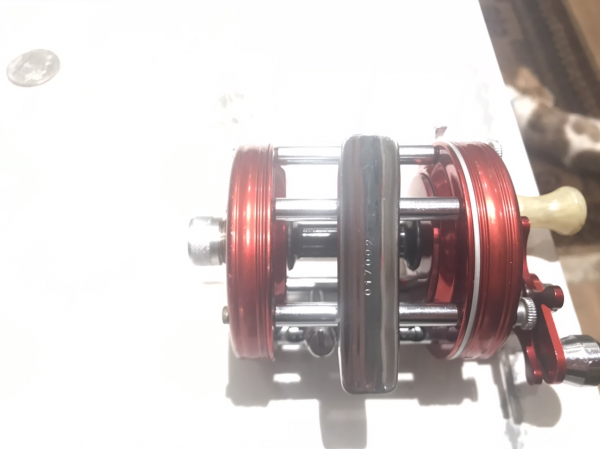

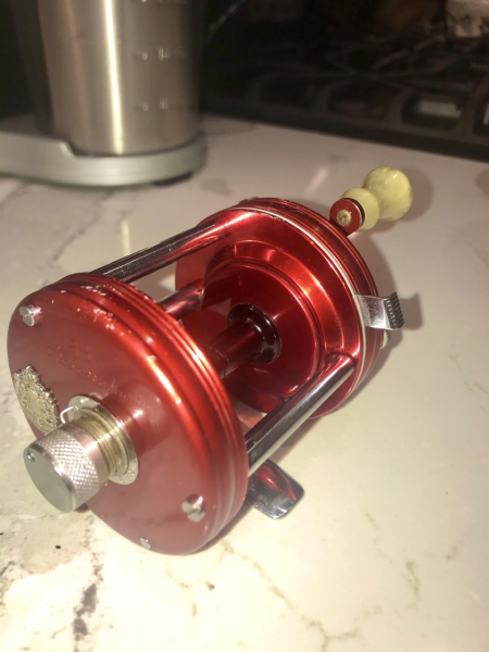

Hello Ohana,
I just got a nice little 6000 in the post last night. I'm assuming by it's design that it is a mid to late 60s model. I picked it up pretty cheap so I was hoping to use this reel to learn what upgrades are possible.
If any of the family already knows what is in the realm of possible, I would love to learn from you. I did find some great motivation already from Mo and TinCanary.
I would like to put a new cage on this, either full aluminum or a CT cage. I would also like to know if it is possible to upgrade the spool and spindle to have the floating spool. I'm sure I will upgrade the gears and add a mag knob, but is it worthwhile swapping out the whole brake plate for a newer version?
Thanks for reading
Nick
Akios has some nice upgrades, very nicely made. There's a few others too. There's upgrades to add bearings to the level wing mechanism and gear sleeve too.
tincanary
There are lots of upgrades available.  You can replace the plastic bushing with a bearing, Jerry Foran sells it.  It will make the reel smoother cranking.  For the spool, Avail, an outfit out of Japan makes them, but they are shallow and more tailored towards casting lighter baits and not necessarily for distance as a deeper spool would be.  Another upgrade is a Knobby Mag, then you'll have a magnet brake to utilize instead of the centrifugal that came with it.  Lastly, you can swap the spool bearings for bushings.  Boca sells them, they're an odd size unlike the C reels of the era which use the 3x10x4 spool bearings.
nelz
Wow Nick, that's a whole lot of upgrades! Unless you're in it just for the fun of the project, you're better off just buying a more modern reel! For fun, try using an old classic like that in its stock form and get the thrill of landing a big one old-school style.
Btw, post the serial # and we'll be able to decipher the date.
Quote from: nelz on October 23, 2020, 04:33:12 PM
let Kick (reefihingproblem) to step on the rabbithole by himself and learn for experience, its the best teacher LOL (kind of expensive teacher if you let me..)
once he had done all the available upgrades for the reel as cage, levelwinds, bearings, gear sleeve, drag washers, spool, handles, etc, etc with all the left over parts from this vintage reel on the table he will be able to assemble the "old" reel again in the same exact form LOL  ;D ;D.. maybe he will just need a set of sideplates that run pretty cheap on fleabay.
that what happen with the hardcore guys that upgrade 113h and jigmaster to the max..

I have definitely gone down some very expensive rabbit holes on Penn Reels. They are my favorite in my collection. I planned on buying a full frame Akios for just under $300, but thought I would learn a lot more by seeing how the parts are interchangeable, or not. Let me set the record straight, I am not trying to pay $1K for a $200 6500CT made out of parts. However, if I never get my hands dirty, I'll never learn what I sought out to know.
I have a beautiful 5000C that is in its stock form except for CF drag washer. It is so much fun. I have a collection of vintage reels in stock form, but like so many of the Ohana, I like to tinker.
Before I forget, I do love learning from those who came before me. I will try to soak up your collective knowledge like a sponge.
