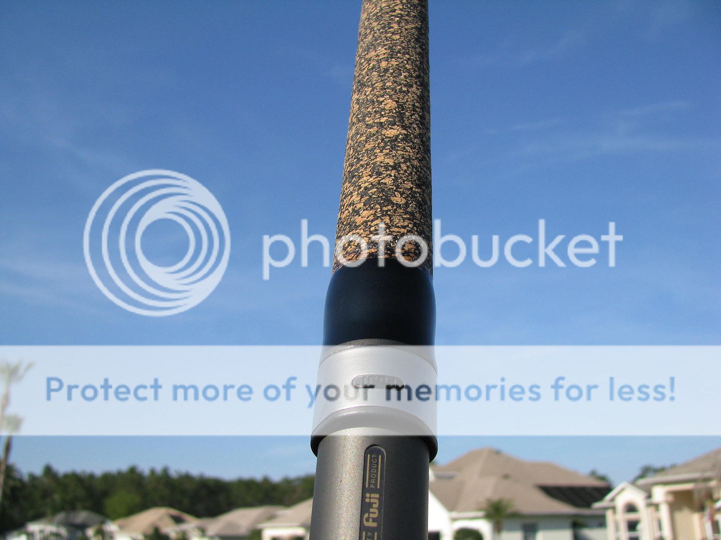

This is my preferred way of cleanly finishing cork tape. Wrap with D black thread and two coats of thread finish. Customers love it.
Dwight
Now...I like that a lot!
