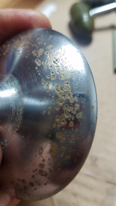

I have an extra senator 4/0 spool that is pitted, I was thinking about filling the spots with some 2 part epoxy, sanding smooth, the a few light coats of spray paint.
I'm open to suggestions.

I have searched this online and basically found a few suggestions/recomendations, but I am nit sure of the difficulty/cost feasability of them.
1). Sometimes the pits can be salvaged (filled) with silver solder and ground & polished only afterwards, if it is steel, brass, or bronze. It needs effort of course.
2)Remove all chrome with sandpaper, smooth pits, polish, have an electroplator plate part to specs focusing first on filling pits.  Likely expensive and might be tough to find someone willing to put in the extra effort.
3)Sand/smooth out pits, remove corrosion, paint, anodize, finish, cerakote, or powder coat part.. or just skip it, wax and use.
4) Use epoxy mixed with metal shavings or similar metal filling product to fill holes, sand finish (or not) wax and use.
Just some thoughts.  I havn't done anything other than sanding/treating corrosion and waxing before continuing to use.. or replace when really bad.

I had a price of $50 USC for replateing  a Penn 4/0 bronze spool from a Crome plating company here in Philadelphia and the spool had no pits to be filled in. A new spool proved to be cheaper.

The epoxy and paint will not last.  If you sand out the pits there will not be much metal left.  Brazing with brass or silver solder to fill the pits and then milling down the surface will work.  That's what a machine shop would do if it was an expensive shaft or something.  But, unless it's DIY the cost will be more than a new spool.
Despite the looks, the spool is perfectly usable as-is.

Degrease spool with solvent, then wipe with alcohol. I'd use JB before epoxy. I've painted one spool that had been bead blasted- I use Tractor Supply Farm Implement epoxy for that. The stuff holds up well on axes and shovels so for limited purpose I expect it will hold under fishing line. Not the best solution but most economical- and if one drops or slams a thousand-dollar Accurate twin drag, that anodize will ding too....
If you have an old toaster, bake it at 150 for awhile to cure but do so outdoors. Otherwise set it in hot sun helps- longer the better to really cure it between a couple coats.
Yes, and most of it won’t show when you have line on the spool.

   If the "pits" aren't rough enough to possibly damage the line, I'd just "fish it", and spend my money on a stainless gear sleeve, and better drags. As Fred mentioned, you won't see much of it, when it's filled, anyway. Any pre -line treatment....wax, grease,...whatever, and good reel cleaning after use, will keep the corrosion to a minimum.

If your going to fish with it, I wood make sure you get all of the vertagus & patana, out of it, the spin it in a drill, using wet n dry cloth, to smooth it of, the place some marine grease on it, & fill it up with line, cheers Don.

A soak in white vinegar will get rid of the corrosion that's deep in the pits. Then a coat of clear lacquer from a rattle can & then wax it with a paste wax not a liquid polish. JMO
