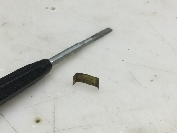

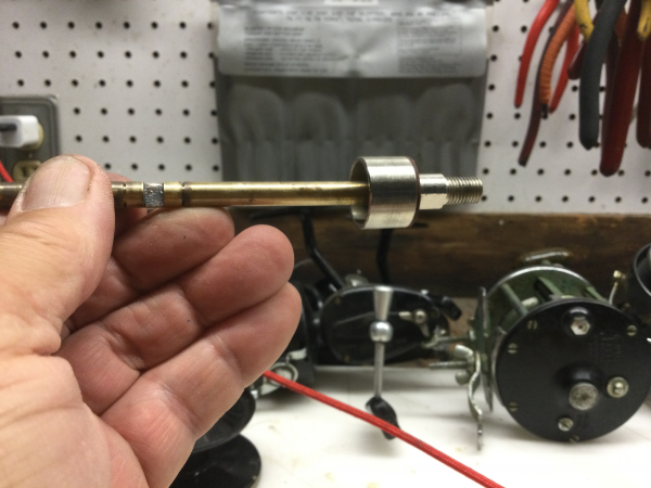

   Reading this tutorial before diving into my 302 was a wise decision...for a reel so large it sure has it's share of tiny parts. Here are a few observations. That pinion key circled in yellow can disappear easily, use caution. The 302 bearing(on the left) in the second photo is dwarfed by the South Bend 960's bearing, although it is a very good quality bearing. The bearing retainer on the 302 is a small affair too, and those c-locks on the axle can fly better than a Squidder's dog spring!
