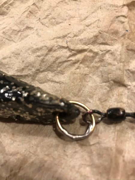

As mentioned last week I hoped to get some more supplies to get this process and itís disappointing parts behind me.   I found some brass..062Ē dia rod and made some rings.
   Using the same flux and 4% silver content wire solder I found that the soldier flowed pretty good and tested the rings by pulling by hand and having a baggage spring scale attached to the wall.
   An example shown below.

Posts: 4196
« Reply #1 on: December 02, 2019, 11:13:12 AM »
Nice
What weight did you test them too?

« Reply #2 on: December 02, 2019, 11:21:22 AM »
The results were pretty good,  consistent at least.   A total of 4 jigs had each end silver soldered twice.
    Only 1 out of the 8 tested broke at the non swiveled end?   What does that mean?
        After redoing the rings again, Iím going to test only the unbroken unswiveled rings to see what I can learn.   Thanks for your help so far 🤙😸🚣‍♀️

« Reply #6 on: December 02, 2019, 04:47:07 PM »
  Thanks for the encouragement.  Yes the jury is out,  the consistent  results so far of these tests were to me more important than these early stages of learning to walk/run. Undecided
  This is brass wire.   This was inexpensive, and fairly available to most folks.     You that need more pounds of proof before a failure have it seems like better materials available at slightly more costs.
Stainless steel in various alloys would be waay stronger in tinsel strength, and a higher silver content solder may be stronger as well.
  But i,m not there yet.   I did locate some Staysilv Black Flux and the mailman brought some approx 56% silver hard wire solder today to play with.  Now i,m not sure if the butane torch will have the btu's to do the job?   Maybe a Mapp job?  Anybody know?
   Another question is how many people trust their snaps, split rings, welded rings, knots,  etc to test them and what is the accepted testing method?     What percentage of line strength should the connecting tackle prove out to be?

« Reply #8 on: December 02, 2019, 08:58:40 PM »
Gary, show us what the broken rings look like.  I tried to do that but when the ring broke it would fly away.  Tried it three times and couldn't find any of them.

Posts: 2967
« Reply #14 on: December 03, 2019, 07:15:17 PM »
As per your request Iíve got a picture of a failed brass silver soldered ring.  Shown below.
  Today 4 more rings were tested and the average test in pounds when failure occurred is 47 ...
      Pulling gradually above fifty pounds by hand becomes kinda jerky....
The better way to pull the test is doing the mechanical thing.  Butt,🤔. Isnít that what we wanted after all.? Huh?     I tried to solder a ring with the 50+ % silver solder butt could not get enough heat from my butane torch.   Whatís poor boy 👦 to do?
