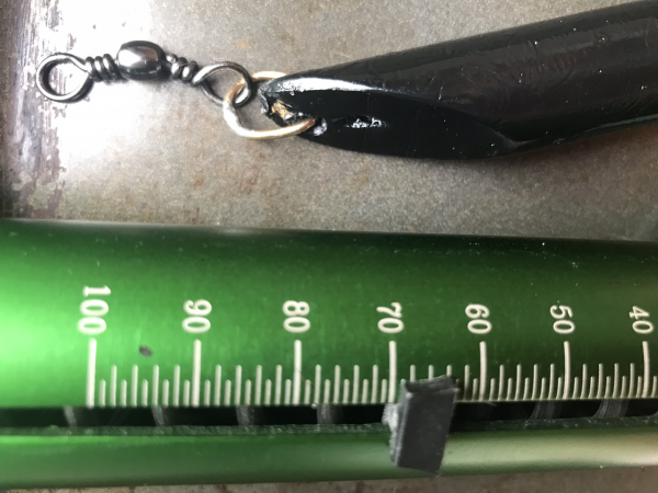

Below is the above average ring tested recently.  I couldnít pull slowly enough to break it by hand 🖐.
    Itís still brass rod/ring and fairly easy to do now.  Of course fish donít just pull in a simple controlled manner.   💥.   Butt to test with the baggage scales that records max spring pressure I wanted to keep the testing uniform as much as possible...🎥

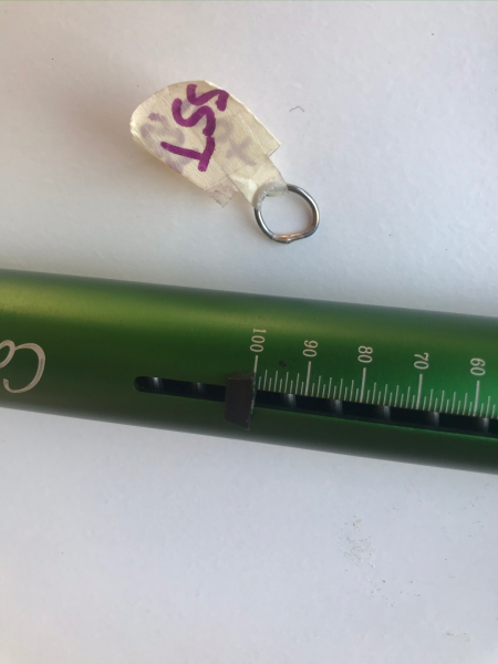

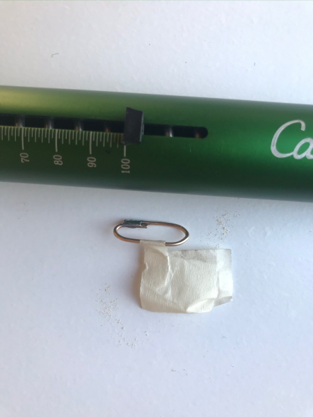

Just in case we could learn something from the spent/failed rings I made a masking tape flag of each one now before testing,  shown below.   These two rings I couldnít break using just my feeble pulling as they measured 80 pounds so I quit to show you.

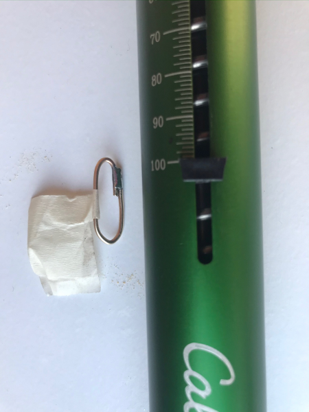

Following also is a lap joint testing that as presumed wood test with a higher breaking strength.  After maxing out my 100# scales and jerking as hard as possible it tested me instead!🧜‍♂️
