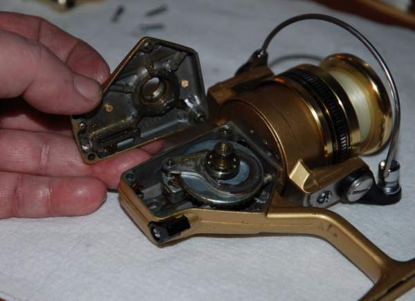

The silver Daiwas have been impressive to me. Been looking for one of the gold series, and good reasonably priced ones that aren't scratched and scarred are rare. Finally found one in decent shape that wasn't a bidding war--the GS-13X.
The handle and body cover have been removed.
These reels have 3 ball bearings.  Removing the one on the handle side.
Removing the oscillating slider.
Removing the screw that attaches the oscillating support to the axle.
Removing axle and spool.
This has been a clean reel this far along.  Doubt if it was used very much.  Takes a 14mm socket to remove the rotor nut.

These are nice reels, but this one doesn't feel as "free wheeling" as some of the Daiwa silvers even though it has two more ball bearings.  It's smooth, but the handle is a bit more difficult to turn than the silvers.  Maybe if I take out a shim or two on the handle side bearing it'll feel better.  No real complaint, just some of the cheaper South Bends, Shakespeare and Compac Omoris, Heddons, and Zebcos I've serviced are more easily turning.  This one has a better quality handle and spool assembly than the silvers.  It weighs 11.5 ounces.  Line capacity is 270 yds 6 lb mono, 200/8, 125/10, and 100/12.  8 lb. mono would be ideal.
.....already found someone who wants to buy this reel, might take them up on it but I want to fish it at least once before I decide.

Ron, I thought maybe taking it back apart and using replacing the Penn grease with Super Lube.  I'm satisfied with the results right now but it does no harm to experiment.  There is absolutely no feedback from the gears, definitely smooth, just a wee bit stiff.
   Yes, Superlube will free it up a little bit. Also check "pinch points" like where the spool shaft(axle) passes through bearing areas, something may need burnished. I do something that saltwater folks frown on...but for freshwater fishing it doesn't cause me any grief at all. I don't grease the pinion and drive gear bearings. I use CorrosionX HD oil. The only set back is if one tiny grain of sand gets into the drive train you'll feel it. There is no "cushion effect" like you get with grease. I guess you could look at that like a warning light...the reel tells me when it needs service! 8)
PacRat
Congratulations Sensei! Before you swap out the Penn grease try just adding oil to key points. This will thin out the grease and you may be happy until your next service. Sometimes I'll do this to an old neglected reel just to help assess it and decide how much effort I feel like putting into it. I've had some crappy old reels feel like butter after this, the extra benefit is that the oil softens the old grease and makes it easier to remove when I get around to a full service. I started doing this when I first started doing spinners. I was using Penn grease on spotless, clean reels and they were feeling a little stiffer than expected (Smooth but stiff) so I started adding 321 in some key locations and the reel would start spinning like it should.
  Yes, Superlube will free it up a little bit. Also check "pinch points" like where the spool shaft(axle) passes through bearing areas, something may need burnished...
roll the spool shaft around on a sheet of glass, to make sure its not minutely warped
polish/burnish the spool shaft below cross-bar & inside the pinion, 'til shiny
