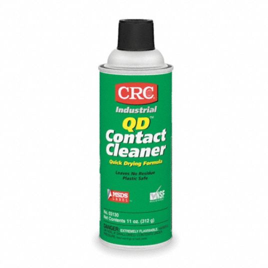

Remove fuses one at a time clean and inspect them for continuity  as well as clean the edges where the fuse goes back in slots or prongs . I use this (https://static.grainger.com/rp/s/is/image/Grainger/1D262_AS01?hei=536&wid=536&$adapimg$=)to clean my electrical stuff of course with the battery disconnected or power plug removed  from outlet on house hold stuffs
Corrosion is a Boats and Auto worst nightmare and can happen overnight and always happens when stored long periods of time .
Also look for a main Ground Terminal or block to which things may be connected and insure that is clean.
Generally this will take care of things and then if you are not going to use the boat for a long time disconnecting the battery will help with corrosion build up (not stop it) but help .
