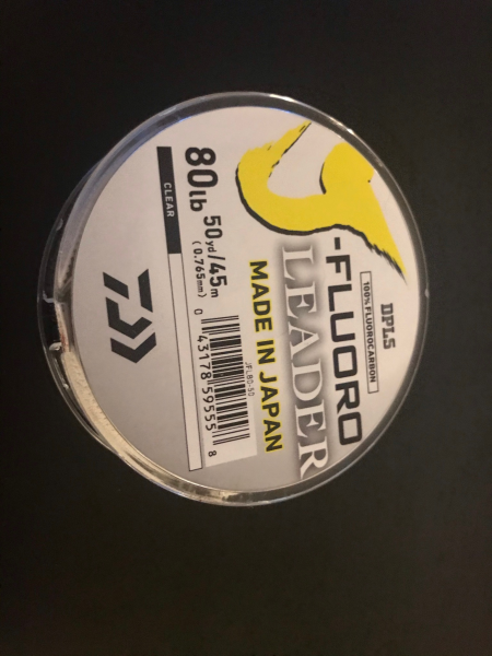

I purchased a new leader spool of this shown Diawa 80# fluorocarbon recently and proceeded with knots.

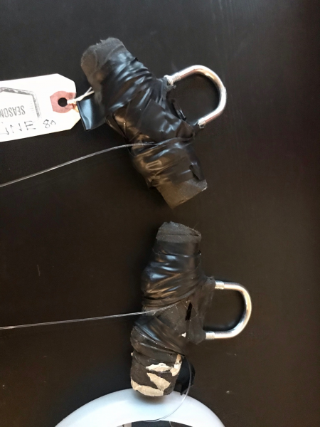

    The testing was done by me.  No knots, just wrapped and taped on the tube/ u bolt thing for pulling......
The line was kept from over lapping as much as possible.  Tape was helpful in binding.   The pulling was with a come along type ratchet device.  This allowed control, and examination.
   After 7-10 repetitive tests, my results are that this line will break at 45-60# and never above 70#
Most tests were performed at about 50-60 degrees f....
   Never once did the line break in the wrap area that was taped.    Just wondering?

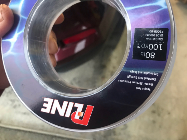

Kitty 🐱 said to mention the P Line tests broke between 75- 85#,   Not fluorocarbon, just a big difference,
Uh-Oh.  Diawa strikes again.  You're a walking dynamometer Gary.
I did something similar with 20# Blue Seaguar not long ago.  Best I could tell, it broke in the middle at 24-25# pulling by hand with twenty wraps on dowels.  Trying to watch the scale while slowly pulling by hand makes my hand shake a little so the needle on the scale jumps around a little.  It might have been different with a steadier pull but I think it's in the ball park..

After the testing of the dismal Diawa line another test was performed on the P line leader spool that was recently purchased.  This seemed to be better and costs less.    My knots tested did reflect the difference in the change butt still couldn't hold more than 75% of rated mono used.
  I,m ok with my knots now as the drag is another variable.   You don't know until you test.   Gst
