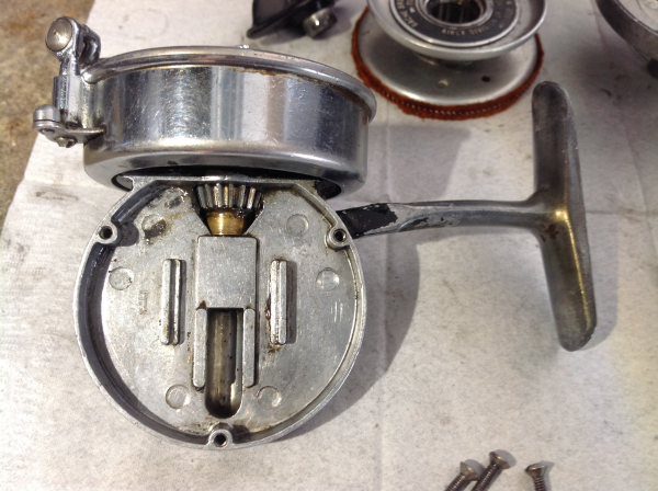

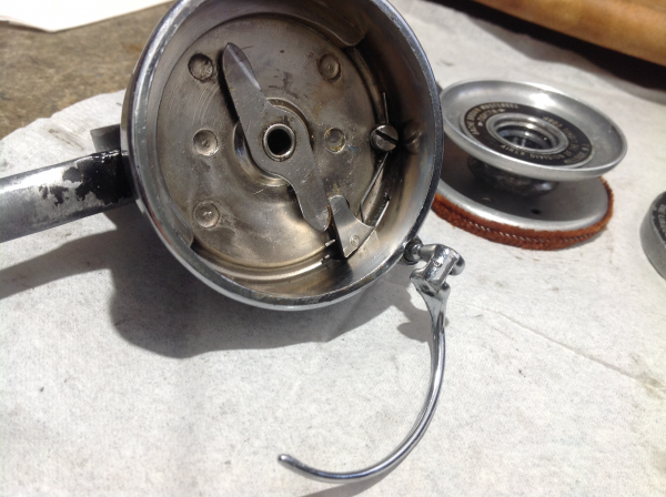

Here's some photos of a 3, for reference? I posted a bit on this one years ago, cause I was impressed with all the metal in this reel.
Don't recall taking the bail apart, though. A full bail model's godda be different. Midway Tommy seemed to know some details about them. One thing I found-out was that the rotor is rivited on permanently at the propeller - looking part(bail trip mechanisim).

Looks simple, From looking the spring is held in by the screw, looks like one loop, size is small like .022 have lots of that.
Thank you this helps, once I take mine apart along with these photos just might be able to make one.

How did you take it apart?
Handle unscrews?
Spool comes off after you take knob off?
Remove side cover, then how is brass square held on?
What is the little pin beside it.
I haven't touched mine yet.
If you have dis assembly instructions.
Just don't want to break any thing that is simple by doing it wrong.

Never worked on a Model 4, but other than the full bail it shouldn't be a whole lot different than a Model 3. Start disassembly & post some photos & we can lead you through the process. You do need a special tool, which very few people nowadays have, to remove the rotor and pinion gear & tube. You'll have to just thoroughly clean and air dry that area & then lube it.
Schrack
Roger Dat on special tool.
What can you use?
Pliers do not work, can't get a hold and this part has to come out to get to bail spring.
The pin is screwed into shaft. Would assume Left To loosen.

Sorry Schrack. It was so long ago I don't remember and the reel's about 3000 miles away on the mainland. I left the rotor assembly intact, but can only tell from the pictures I saved. One thing I disliked was the plastic spool bushing---mine was cracked. Liked the big main gear though. The pinion is kinda large and the gear ratio is still less than 4:1. Can you do pictures?

Without that special tool, made solely for the service techs, you can't get the rotor off, so forget about that part of disassembly or you'll ruin the reel.
