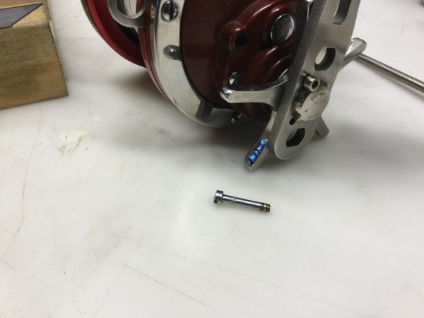

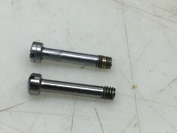

Me again....I just went through the Tank making sure all the external screws were tight and discovered one of the upper bridge screws is stripped.....the screw that has the partial threads and goes through the yoke.....I would replace it but have none in stock.  Does anyone have an extra? Otherwise I can pull one from another reel.

Man I sure hope I am WRONG but it looks like the screw pulled some thread out of the plate when you blow it up  and you will need another plate and a screw .
I think you are right....I should have looked closer and tried a different screw....Bill

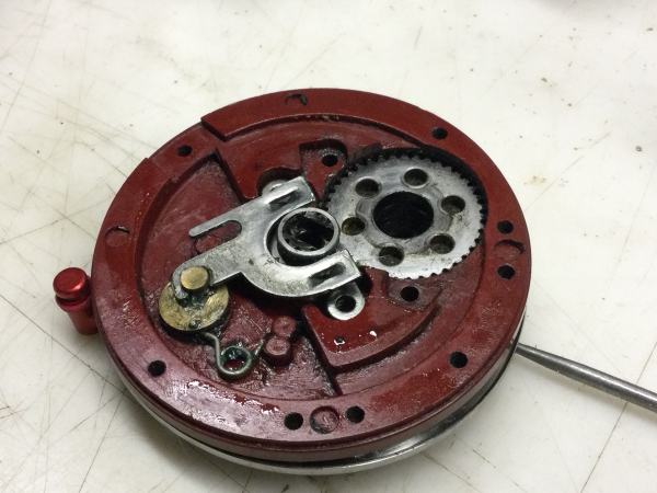

Maybe of interest, did it have two Dogs, the new plate may need modifying, cheers Don.

The Bridge Plate is the Same Dual Dog or Not on the 113 . It is the Side plate where the Dog fits in that is different .
Sal Modified the Plate to accommodate Dual Dogs and put it in a thread quite some time ago .
The Newer versions of the Side plate has the Cut out in them for dual Dogs .
I will link the thread when I find it . Beautiful work he did  on this .

Crisis adverted.....opened the Tank and found a stainless steel double dog bridge.  The original brass screw WAS stripped.  Replaced it and we are back in business.  Bill
