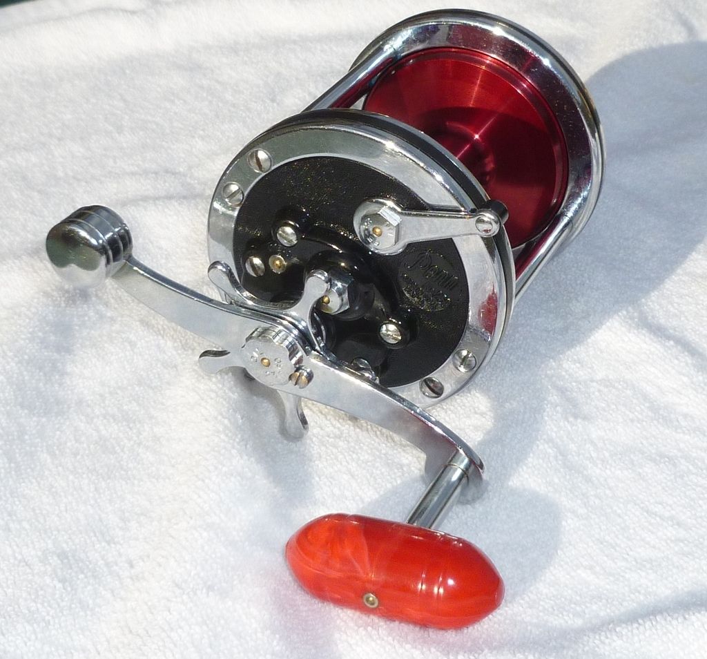

Aiala
I really like this classic 259, which I restored and dressed up with spacer bars, a red spool and matching red handle:
Pretty enough to be a shelfie, but looks/feels so nice I want to take it fishing!   :)
~A~
