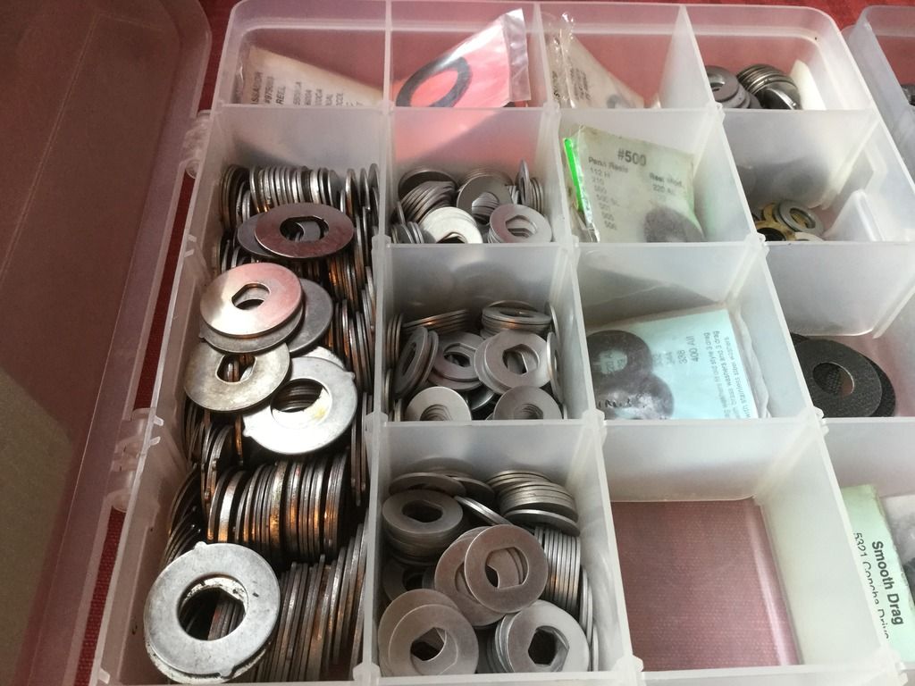

Quote from: Alto Mare on January 08, 2016, 12:28:28 AM
I see your point, but as stated above I have no issues using the penn brass washers and carbon fiber washers with a touch of Cal's in my smaller reel. No brass paint on those at all.
Good to know, I wasn't sure if you were running them dry as Penn did or greased...I had a pair of Daiwa BG-90 spinners which used a combination of stainless and bronze (not brass) washers, also a Templar 500 that used phosphor bronze...No problems with greased CF on those and both were super smoooth..
cbar45
My larger reels only get stainless steel washers, some will also get titanium, but only when I get a hold of some.
Look forward to your feedback on titanium alloy if you haven't already posted it on here...That sounds like the ultimate for a reel seeing extensive use in the salt, going long periods of time before ever seeing service; even stainless will corrode given the right conditions..
