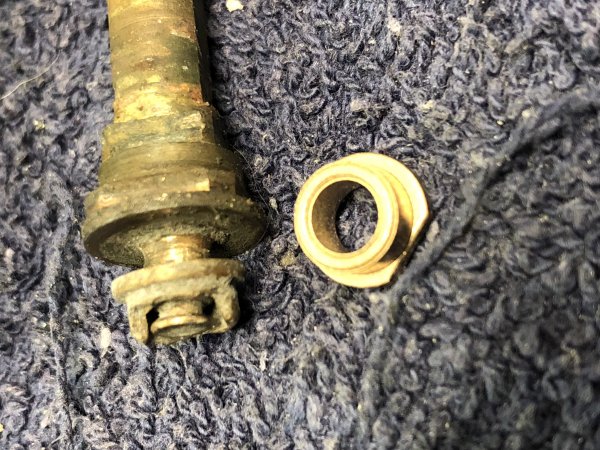

I have 20 of the 20/40 reels in the shop from a charter boat. Every one of them needs a new drive shaft bushing. I hope Shimano has enough.

So Keith, are those drive shaft bushings prone to failure or were these reels subjected to extreme abuse and/or lack of maintenance?
I own 3 myself but have never used them. They seem to be bullet proof.
Keith
Won't the Trinidad drive shaft bearing fit if you can't find bushings?

Tearing down and cleaning/upgrading  a 15/30. Any updates on these bushings? Would TSI301 treatment, and then some grease improve durability?
there is a bearing to match the bushing.  just measure it and we can find one.  i likely have a bunch.
These reels have been rode way too hard over the years. The gears are fine. 8 of them the hole in the frame for the drive shaft bushing has gotten too large.
Your reels will be fine. When assembled the drive shaft bearing keeps the drive shaft stable.
Here is a picture of the worn out parts.
