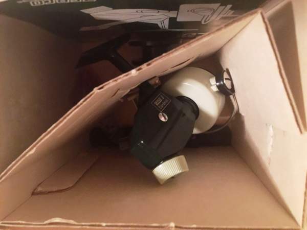

I have a buddy who has gone on a buying spree and now has a bunch of Zebco cardinal 3's and Abu cardinal 33's. I've heard a lot about these reels over the reels, and have seen them in person, but never fished or taken them apart.  He wants me to clean several of them and also remove a bail like I've seen some old timers do. He does have one NIB with original schematic so I can reference that. I've done a good number of modern spinning reels, just wondering if these are difficult to tear down and clean/lube. I was thinking either shimano drag grease or Penn blue on the gears. Freshwater only reels.

Thanks for the picture with the sideplate off. I'm getting the reels tomorrow so I might be posting questions over the weekend when the work begins! Looks like the going rate on fleabay is around $175

If that's a Cardinal 3 it has a Cardinal 4 drag knob. The ridges on the 3 drag knobs are finer and closer together like this one.
It is a 4 Tommy. How many different models are there?
So far, I only have a 4 and a 6.
