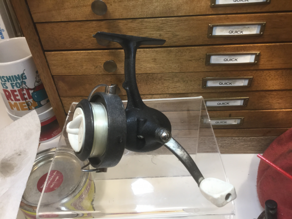

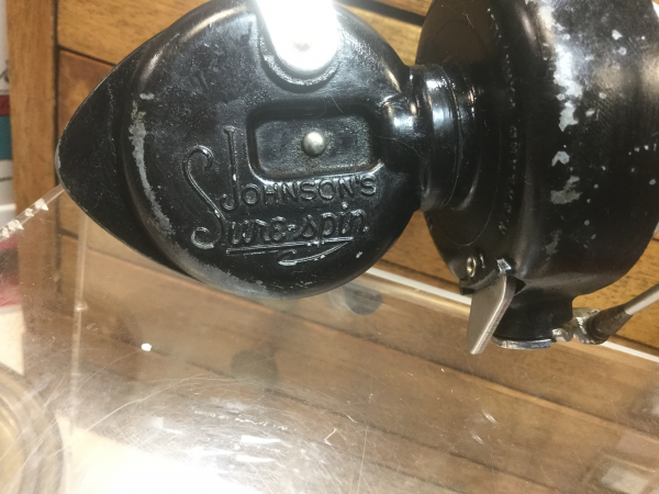

Here is an old Johnson's Sure-spin —
It is listed in George Thommen's 1954 edition of "The Complete Guide to Spinning Tackle".
So it must be a little older than that, 1950 vintage, maybe?
Anyway, not even a bit of plastic anywhere — but a basic low quality reel compared to those of 25 or 30 years later.

Nice little reel Fred, I have something very similar in green, I believe made in NY.

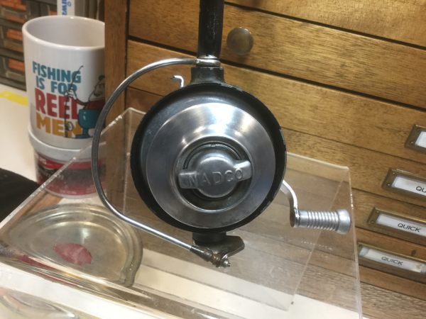

Can you tell me anything about this Swiss Whiz, Fred?
At first glance it reminded me very much of my first spinning reel--the old Zebco 707. Gave $2.99 for it at Star Sales in Knoxville, TN.
As you can see, Chester — the design is similar on the Zebco 707 to the much earlier Swiss Whiz from around the very early 50's.
The SW has more metal — the 707's are mostly all plastic.
Now, Zebco made some really nice high quality early all metal reels during the same time they made these entry level 707's.  They were identical to the earlier Langley's, with just color differences.  These were Zebco reels such as the 822, and others of the same model group.  I have maybe a dozen of these.  Some are unused — and they are wonderful, solid reels.  Good action, solid mechanics, sharp and crisp bail return.  And they were not inexpensive when new back in the early 60's — running $15 to $19 at that time.
The 707 listed for a MSRP of $5.98 in 1965.
Here is a Zebco 707 that was in the bottom of one of the old bins.  It has never been used, and still has the original factory line and clear plastic line keeper on the spool.
Took it apart for pics, still had the original honey grease inside — added a little more grease as well as some TSI321 — took pics, put it back together.  Whole process took 6 minutes including disassembly, pics, grease and oil, and reassembly.  Dead simple little reel that weighs in at 5 ounces.  Good for kids to learn how a spinner works on bluegill, trout, and panfish.  No bail spring, no A/R, no dogs, no springs, 80% plastic.

You are right, Sal — made me cringe a bit also — but I know that Tom knows what he is about, though.
