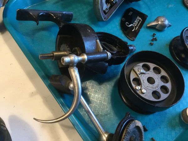

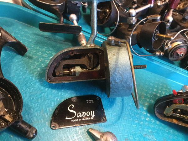

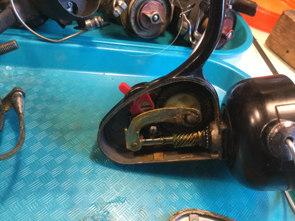

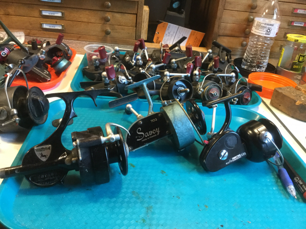

How about these?
Centaure, Savoy, Bretton?
Take a look at the engineering of the Savoy 702 in the middle.
Then the Martin/Bretton on the right.
Last, the steer horn bail Centaure on the left.  I still fish one of these as a personal reel occasionally.  They are well balanced, and when fishing with a loose line — no bail is easier to engage and disengage quickly.
