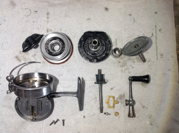

Ok, I can offer up 1 circular gear box reel from the US. This is the Bache Brown Mastereel, model 3, from the Airex Corp. which is a division of the Lionel Corp. Wow, that outta be an interesting buisness history. This babies got alota metal in it!
Here's all the disassembled parts. Plastic parts are the drag knob, the handle knob and the spool sleeve. Don't know metallurgy too well, but it has an aluminium spool, what looks like a stainless steel rotor(chromed brass?), brass pinion and bushings, mabey an aluminium body and the main gear-?

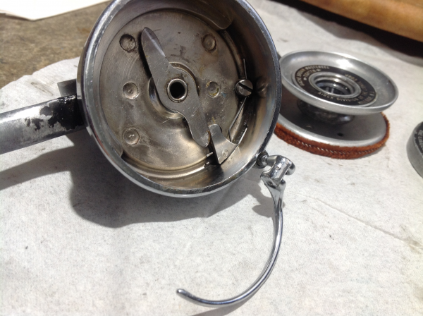

The "half bail" and auto-return system. A sturdy lookin system: the bail piviots outward and note that there's a little knob at the bottom for manual(finger pressure) return. The rotor seems to be permanently attached to the pinion underneath the body and possibly by the rivet on the propeller lookin return unit. Also the line roller is permanently rivited to the bail with an oil hole on one side.
That would be one negitive for me, these and a few other parts such as the handle knob, are not replaceable other than by peening or riviting. As I remember my DAM Quick 250 standard, nearly everything was held by removable fasteners.

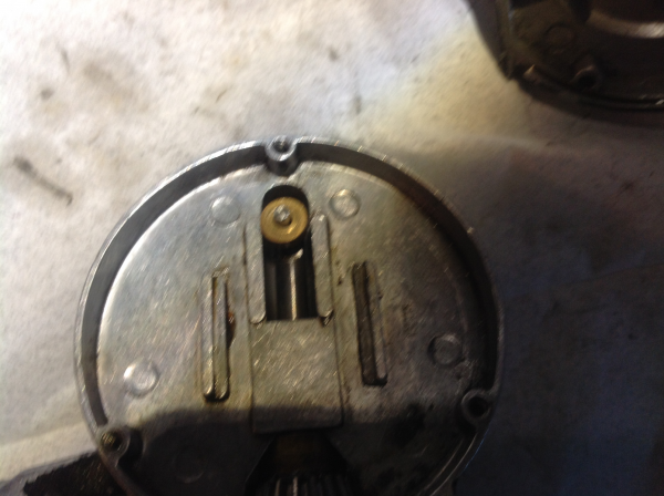

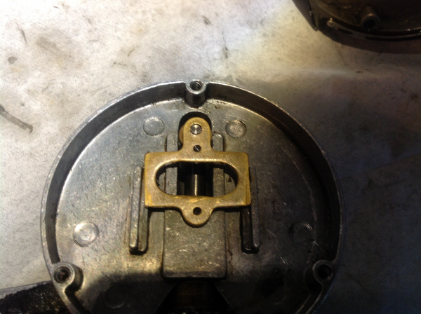

The ossilation system. Simple: a knob on the main gear that actuates a brass ossilator, a nice little brass roller behind that and then there's a modified screw in the spool shaft.
