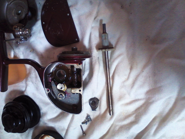

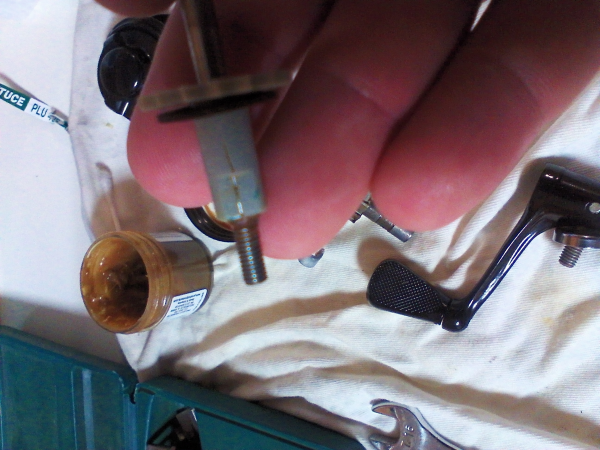

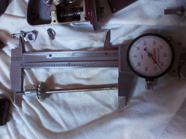

OK, I took 3 pictures. Now I need to figure out how to post the pics.
I'll add these pics for Jim — Best, Fred...
Those may have even been molded directly on the shaft rather than hot set. If you look inside the split you'll see a couple of grooves that are more than likely to hold the plastic in place. There is no joint under the washer between the bushing portion and the click gear.
