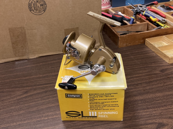

First "B-grade" spinning reel:
Compac SL series: 110 (light ~6lb), 111 (med ~10lb):
These SL-series reels could just qualify as "B-grade" simply by being Japanese reels from the 1970's. Back then, as I remember it, "Made in Japan" was not a compliment. That has changed over time of course and it seemed that lower end reels then started coming from Korea (80's), then from China (90's).
I bought these Compac's following my curiosity for gear train designs, and they smacked of an Omori design —or an Omori copy? They sport the compact, "efficient", helical (spiral), hypoid (off-center) gear train that seems to have swept the industry since the 70's. Piquing my interest has been some chatter that these SL series reels are of better quality than other Compac reels. Could this line of inexpensive reels be worth pursuing? Now, I am an angler, more than collector, so I'm mostly interested in reels that can perform on the water.
So, let's dig in and see what we've actually got here. Or what I can get out of them.
The 110 was found to be well used. The 111 was nearly new, in the box, with papers. It's helpful to have one in such EC in assessing the quality of a reel design.
The first thing is to assess how much a reel has been used, and how well it might have been taken care of. This is especially important with lower quality reels as they are more apt to gather wear. Turning the handle rarely offers much about the condition of the internals, beyond their containing old dry grease. Few old reels I pick up have been serviced, let alone treated to a complete job.
Bails are apt to have trouble and I'd bet more spinning reels are discarded due to bail issues than any other. Often they are easy to get back into working order. Broken bail springs can be bought, or close-enough's modified. Bail wires may need to be bent back to shape. This SL110's bail was found to be sitting askew, the culprit being a worn nylon bail bumper. In fact, it may have been a sloppy replacement, owing to the apparent dried epoxy around it. I'll have to drill it out and replace it with a piece of weedcutter line, or other such material. This in itself suggests the reel has been well used.
Opened up, the reel showed dry, gummy, likely factory, grease. And here is what I was interested in: How this reel was put together and the quality of materials used. Both these SL's were virtually the same in terms of design and materials, both being destined for L and M freshwater use, respectively. They sport a helical hypoid gear train. Shaft oscillation was accomplished via a grooved cast-metal oscillation block against a raised post or button on the back-side of the also cast-metal main gear. Metal quality appeared poor, possibly a high zinc content alloy?
These SL's do not have a pre-pinion AR that is common now, instead relying on a ratchet —a set of large gear teeth— on the back-side of that cast-metal main gear. The AR being reliant on the good nature -metal quality- of the main gear. Such an AR is likely fine for a light power reel like the 110, and for most requirements the 111 was targeted to. Pushing the 111 above 12lb line, very often, perhaps might cause problems? At least when using the reel's drag. I'm a back-reeler so AR durability will never be an issue for me. The AR is there simply to keep tension on the line/lure when not being fished.
The main shaft is chromed, but apparently over a soft enough metal (likely brass) that I found the shaft on the 110 bent slightly where the screw that holds the oscillation block is drilled. I think I can see how that happened. The block is screwed into the shaft, and the main gear, affixed to the crank handle, puts that cranking power down onto the shaft via the oscillation block right where the shaft is weakest -where the hole was drilled through. Whoops! Design, or materials, change needed there. I popped the shaft back straight with a small hammer and a piece of leather.
The handle shaft of the main gear is supported by a sleeve bearing (brass?). The main shaft is supported by the rotor ball-bearing, the pinion shaft, the oscillation block, and at the distal end via a bearing block of cast metal, integral with the reel body. This is all well and good but, again, the hole in the shaft compromises the shaft.
The single ball-bearing, beneath the rotor, was a poor fit between the ball bearing itself and the reel body housing, the bearing being a bit loose in the housing, creating some play in the reel's shaft, rotor, and spool. A replacement bearing would be best, but I made a quick fix by fashioning a shim from the finger of a Nitrile glove. It took up the space, noticeably tightening up that play. I had to do this in both reels.
I burnished the important metal-to-metal contact areas including reaming the inner bearing surfaces with 0000 steel wool in a cordless drill, as is recommended by Fred (foakes). Lubing was done with Super Lube grease and oil. Final step is to use the reels as fidget spinners, spinning them to distribute lubes and "set" or "mesh (?) the gears. For some reason this seems to help smooth things out. The more worn 110 is the noisier of the two, with a bit of gear-buzzing going on. New ball-bearings, and creative shimming in the right places might help both reels. Any and all advice is welcome!
In the end, or in their native form, these SL series Compac's are not terribly impressive. Sadly, they feel... cheap. Both suffer from excessive play in the components, resulting in loose somewhat noisy (clunky sounding) reels. At this stage in the game, I'll likely be looking further for fishing companions.
The last image shows the '80's Omori Shaky Sigma (035) and the '70's Compac SL (110). Two hypoid geared reels but very different animals on the inside in terms of design, materials, and tolerances.

For academic purposes I went back to work on the SL 111 in an attempt to quiet the noise this cheap reel produces. Nice, once again, that I have an essentially new reel to start with, which tells me something about the native components of this reel model.
There are a variety of noises that reels may produce. The most common culprits seem to be: the ball bearings, esp the one supporting the rotor; the gears (how well they mesh); the other support bearings; and the main shaft movement tolerances. In fact, much unwanted noise seems to boil down to poor tolerances between moving parts.
This nearly new 111 hissed, ground (mildly), rattled a bit when shaken about, and clunked when reeled. Together these were intolerable, at least for someone who has better choices available. But I wondered if I could actually tame such a beast, retaining original parts. In the end, the reel would not be worth an attempt at upgrading parts.
Here's how I attacked each noise:
-The 'hiss', I have always called "rotor hiss" —I guess bc the rotor tends to amplify the sound— is the sound a cheap or worn/corroded bearing makes -either ball bearing or bushing. I dealt with the cheap ball bearing in these reels by packing them with grease, as opposed to oiling with a viscous oil.
-The 'grinding' is gear noise, due to how well, or poorly, the gear teeth mesh. If you press a reel's tail against your ear you can hear any gear set, even those glass smooth ABU worm gear ones. But they should not be heard, very loudly anyway, much further away. There wasn't much I could do with the gear noise in these Compac's. The gears are just too loose. Extra grease was all I could think to do here, hence Wompus Cat's "peanut butter" suggestion.
-The rattling and clunking I spent some time trying to locate. The majority of it turned out to be emanating from the main shaft, and were amplified in the rotor cup. These cheap sounds were intolerable. I decided the best I could do was attempt to hide them! I eventually traced the sounds to the oscillation block. It was clunking back and forth between the pinion and the aft block bushing. So I made a pair of cushions from heat-shrink tubing. They had to be narrow so that their impact on line lay would be as minimal as possible. Hey, I didn't say I was going to fish these reels, just hide the sounds of cheapness and poor tolerances. But... hey, you never know, so I exchanged the shim/washer beneath the rotor for a thicker felt one to pick the spool back up a bit... just in case.
This bit of BS helped but did not get rid of the main 'clunk', that came around at every fore and aft movement of the main shaft. The only thing left was the AR cog and groove, and this turned out to be it. I affixed a heat-shrink shim to that little button/cog and... that hollow 'clunk' went away! How cool is that?! The shim did not stay in place exactly, after opening it back up to see, but it stayed in the groove and continued doing its job. How long? Who knows? Hey, this cheap reel got a cheap fix. I effectively hid the most egregious sounds of cheapness. I would likely need to find a more durable shim but I'll call this effort a success.
What's left are the hiss from a cheap ball bearing (remember its essential new) and the loose gear mesh noise. I dare say it sounds 'fishable' now. I could join a line of casters in the dim light of dawn and not cause wrinkled noses and curled lips from my compatriots. That said, from what I've seen, I could now see dropping these Compac SL-series reels into the "C-grade" category.
