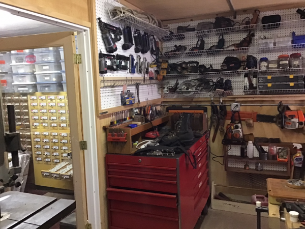

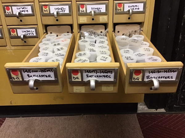

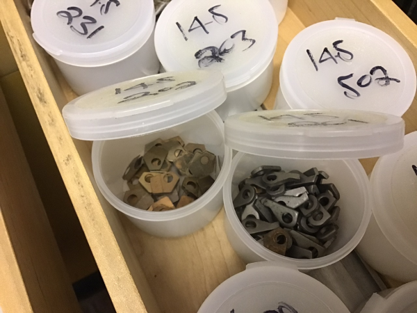

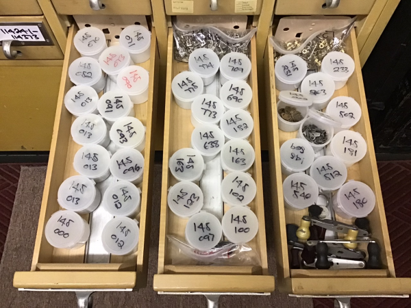

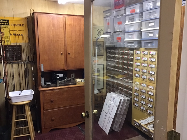

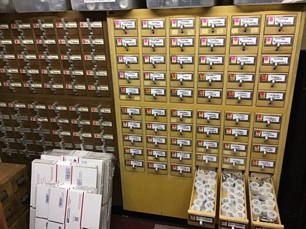

Hi David —
Went out this morning through the snow — to the outer shop — where I keep some of the less used parts.
I glassed in and sealed off this little room so that it would not get dusty or mixed up with the metal, wood, or painting areas of the other adjacent shops.
This is where some of the parts are stored that are not used too much — organized them last year into individual part numbers.
If you want a new ratchet pawl (A/R dog) & copper wearing part — just let me know, and I will send them to you at N/C.
Will need to know by tomorrow if you want these — because we are pulling out early Monday for a week at the Coast.
I can drop them off at a Post Office on the way over to San Simeon.
