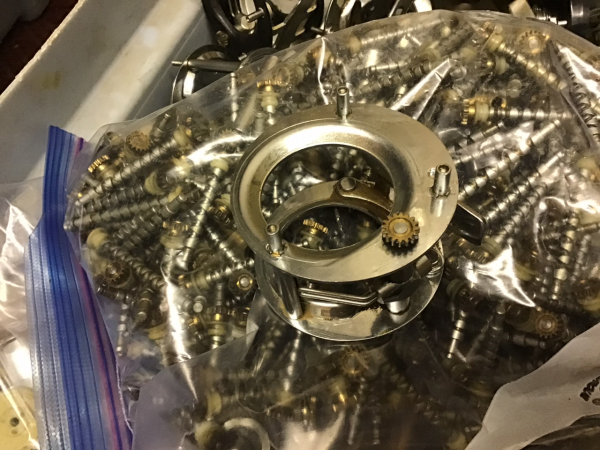

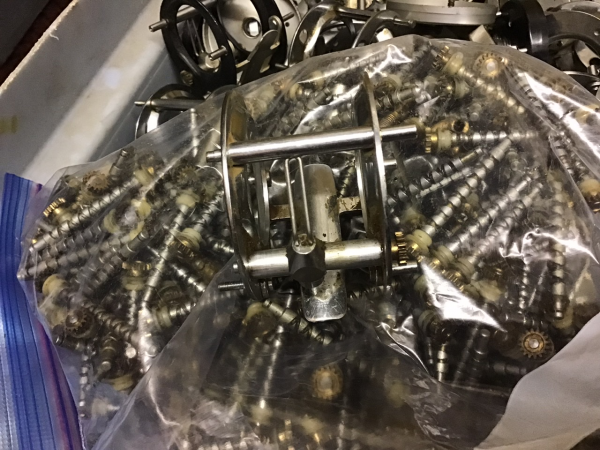

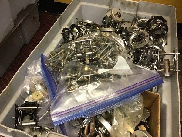

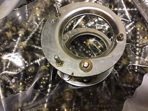

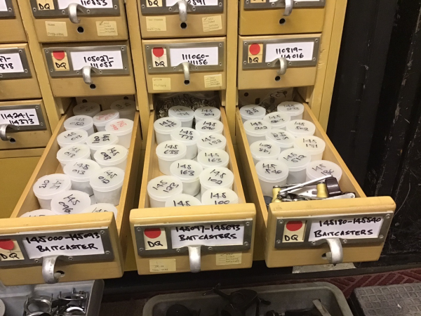

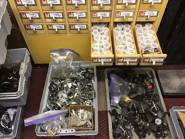

There is a box in the outer shop of around 70 pounds of these in different levels of disassembly — from completes to skeletons.  Plus I have 5 drawers of all of the parts as NOS.
