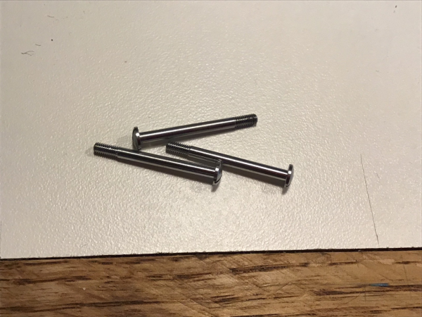

I'll drop some new screws in the mail for you -- No Charge.
The screws are specific to DQ -- and cannot be found anywhere.

Just shoot me your full name and address in a PM -- and I will try to send them out on Monday.

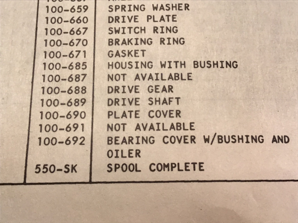

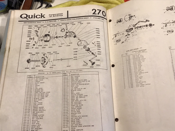

The latest DQ Shop Manual from 1983 -- shows these screws (#100691) as not available.
Fortunately, I have plenty.

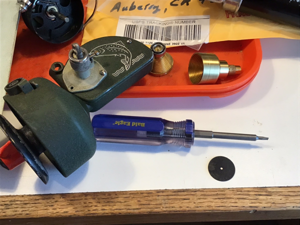

* A Dremel cutting disc was used carefully to deepen the screw head slot
* Then a "Hollow-Ground" screwdriver of the proper size -- along with a good gripping handle -- and solid down-pressure

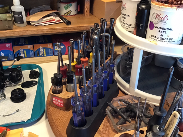

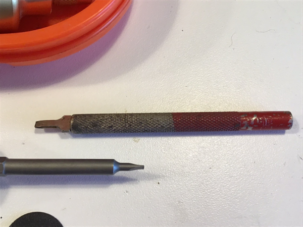

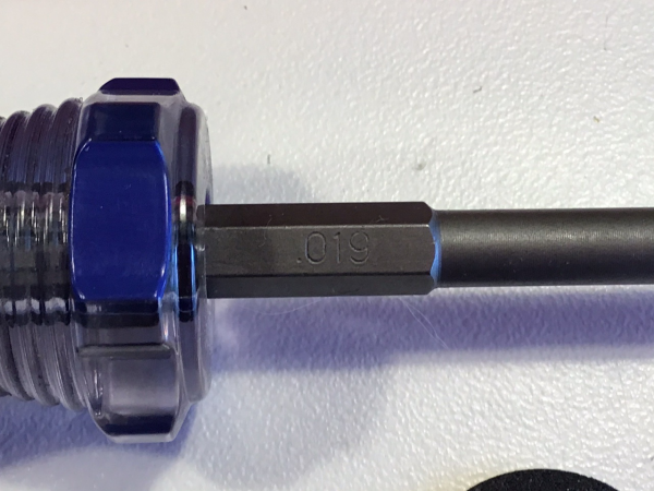

Screwdriver I use is a hollow ground Gun-smithing driver in .019 size.  Also, just a driver bit would also work, and is less money.  This operation needs to be done without a power screwdriver.  Just strong, steady downward pressure with no slipping.  You just need to break the bond 1/8 of a turn and it will come loose.  No issues.
This old red scribe screwdriver will do to gouge the slot.
Here is the type of cutter that works in the Dremels.
This set of (6) hollow ground screwdrivers cost about $19, shipped.
Dremel is around $40 - $50.  Useful for reel work, but not really necessary unless you are doing a lot of reels.

Here is the inside of the DAM Quick Super all cleaned up.  I used a combination of Cal's and some Reel-X oil.  A light dose overall.  When I use up the Reel-X I will try the TSI oil.  I owe a big thanks to Fred for getting the screws to me.   I put the Penn blue grease on those.  I did remove the pin that holds the main gear to the handle shaft and was glad I did because that really is a key area that needs lube.  In my opinion this reel really has an elegant and simple interior.  The only thing that made me nervous was banging out the pin.  I saw a video of a guy putting it a vice, but I opted to support the reel with a wood block and the pin just indented the wood as it came out.  The bail is also easier to service (for me) than the Mitchell 302.
