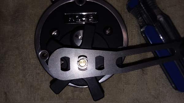

I tried both a Newell and Alan T's ss Newell handle and they both fit nicely without alteration. Either handle fits without removing the clip from the end of the gear sleeve.
The Boss' ss Newell handle
A Newell 500 Series handle
-Mike

Don't need no stinking Calipers !
Seeing is Believing  ;D ;D
The Boss will have another order ;D
Thanks Mike!
